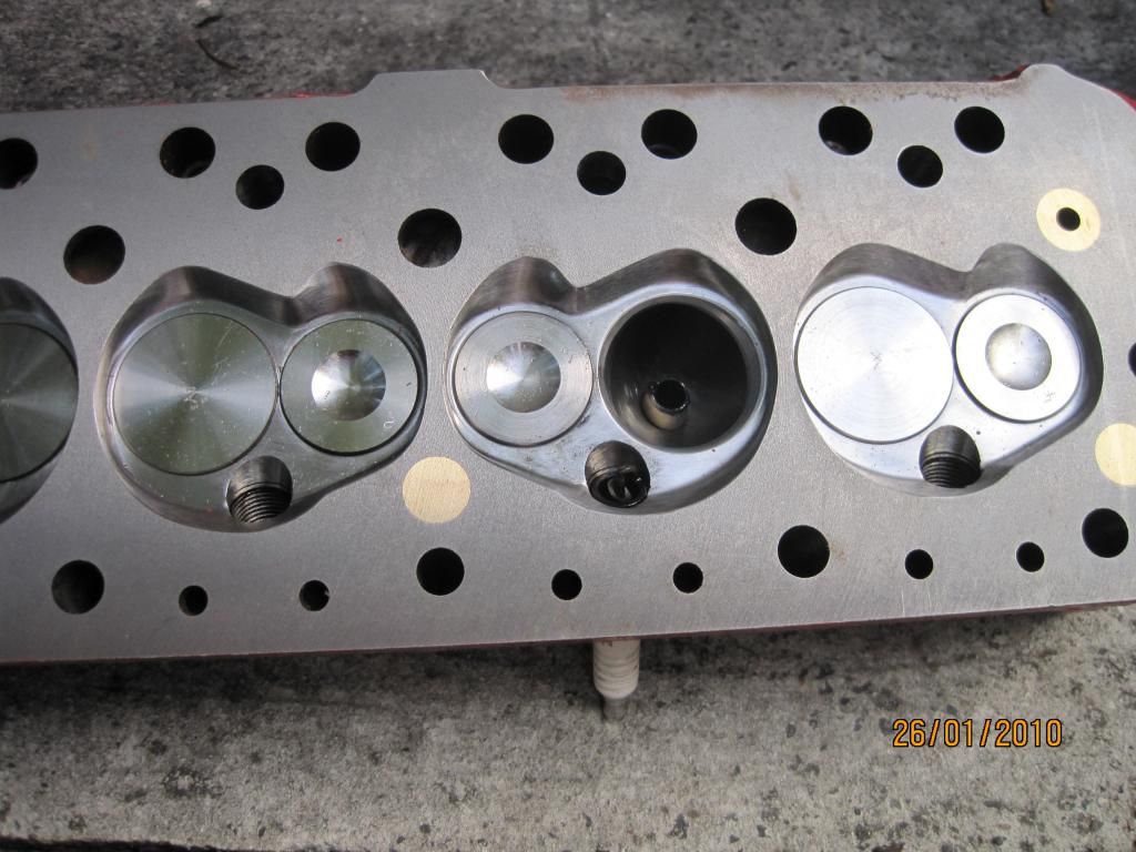

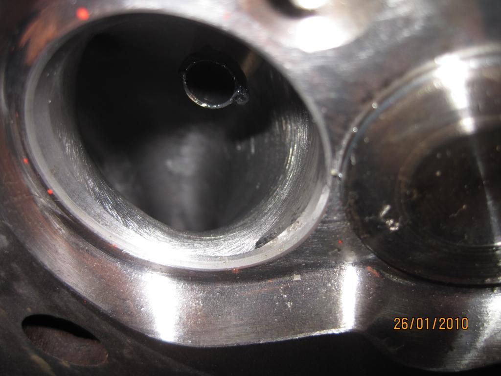

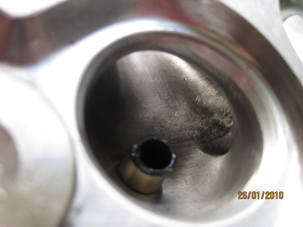

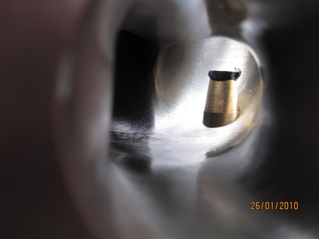

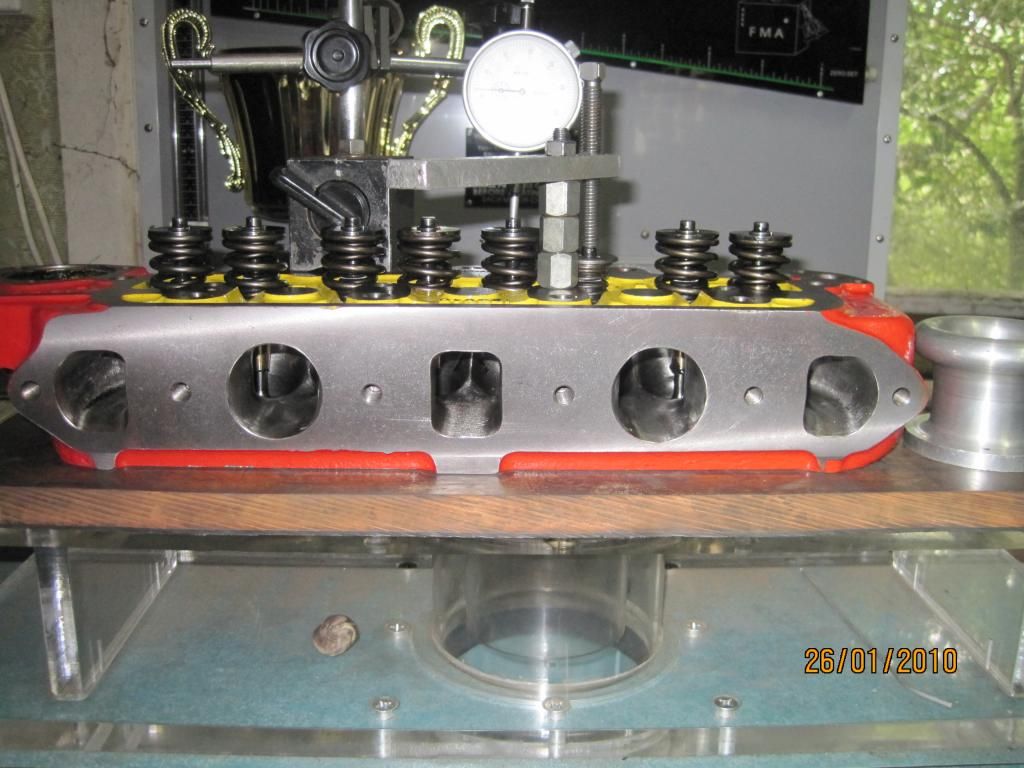

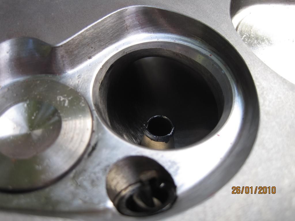

850Man,
Just for you 850man. Here is one of Swiftunes, full race, all singing, all dancing, 1.5" inlets, 1.25" exhaust offset.
The presentation of this cylinder head was impeccable, awesome, great! (unlike mine :D) This is a $4000aud cylinder head, landed here in Sydney.
My full race heads look nothing like this, and for good reason. :shock:
Graham Russell

hey GR sorry to ask this, i dont want to get yelled at, but what does that head actually flow, compared to yours, in the same spec, i know you might not want to tell. and thats cool.
ive seen CNC ported chev heads get out out flowed buy a guy doing it in his backyard, it doesnt matter what it looks like or how much you spend its what best suits your application.
but for $4000 that head would want to be the bee's knee's.

Hi GR, I notice the end exhaust ports are D shaped. In my imagination I've thought that would be a good idea
and this is the first time I've seen it......What's your take on it?

HI Norm74
I WON'T YELL AT YOU, :) i would rather not say what the flow figures are as flow benches can vary in figures depending on how many motors you have pulling air through the port, the slower the air speed the easier it is fore the air to turn a corner especially with the mini where the air has to do right angle turn.
We tend to use high air speed to flow the heads as this lets you know if the air is going to brake away from the head when turning the corner, lets just say I get more flow and better flow across the lift range by using a smaller valve this also keeps the velocity up for better filling, think about what is happening at 8000rpm you have a valve that is closed when it opens it has to get that air that is stopped behind the valve moving and fill the cylinder before the valve closes all in a fraction of a second,
The bigger the port the the harder it is to get that air moving, now with flow benches they are the biggest liars of all because the bigger the hole you make in the head the more air it will flow,(ever heard the phrase it flows like a drain pipe) that's it in a nut shell the bigger the hole the more air you can flow through it that's why you have to determine what size valve and what size port you are going to use and get the best flow you can through those holes, and that's where shape comes in to it.

As for Swiftunes head, there are many ways to make a head flow, and high flow rates in ports may look good on paper, and give good dyno figures, but it all comes down to how the engine performs on the racetrack, many a head has been ruined due to a "professional" relying on a flow bench.

I thought i had made a comment earlier on that swiftune head. ... maybe lost somewhere.... it was similar to norms - i wouldn't like to know the volume but rather the velocities,, - i thought those heads weren't available separately but rather only on Swiftune built engines? Is this the one with the widened valve offset as standard and slightly 'higher' port entry?
MG rocket - i would have thought the ideal exhaust port exit shape was round to match the extractor - and maybe the D shape is half way there- and maybe because of everything else in the way it stays like that - but i do wonder why new alloy heads don't use the shape...perhaps again on reflection the cross sectional area would be too big?

Round for sure, just probably not feasible on the standard cast iron head without some sort of filler
on the inside radius.
Just that on the heads I have, it seems that the last bit of the port needs straightening so the easy way
to do this would be to grind out that D shape.
