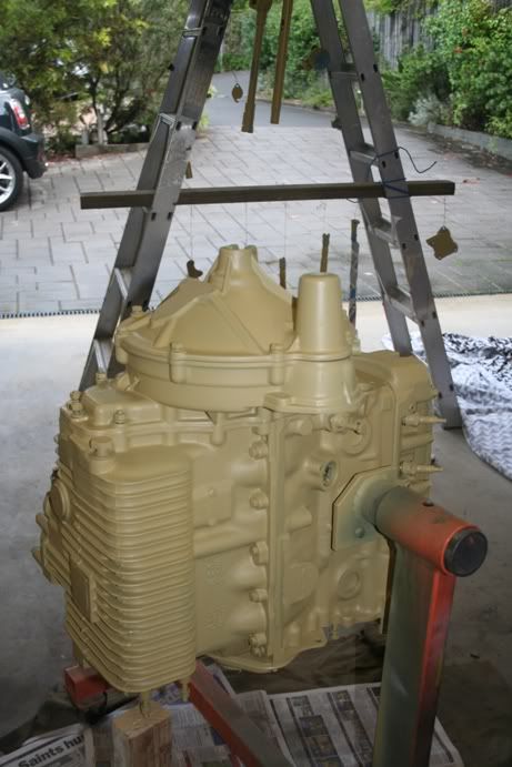

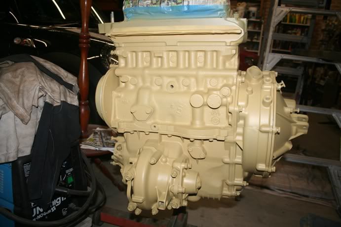

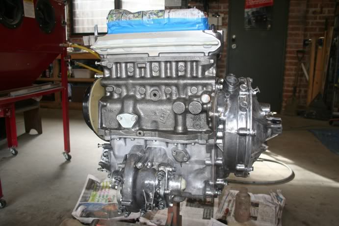

Etch primed the engine assembly today. Now ready for the top coat.

Probably the first time I've ever seen an engine etch primed.
Can't wait to see the quality of finish on it :shock: 8) :D

Sorry Gafmo
After cleaning and polishing the engine it is now painted with an etch primer, which is matt finish
It will be finished with a gloss paint, hopefully this weekend if the rain stops

I did read the the Etch Primer but for some reason I though it was the first pic. I was wondering why you would go Matt after the etch. Looking forward to see how the engine look after all the work you have done on the Body. Keep up the Great work

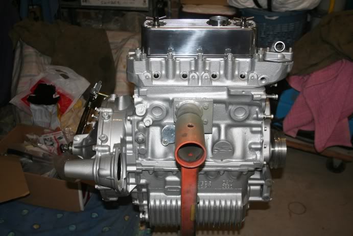

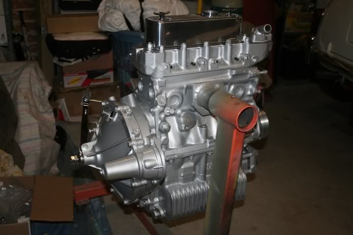

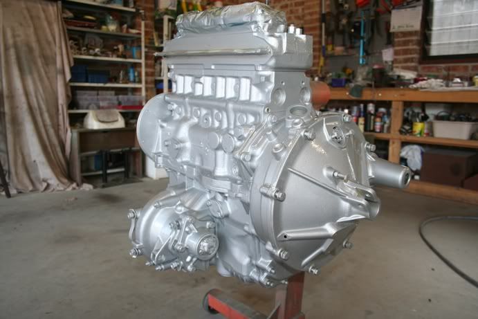

Finished the engine assembly all good, I pinned the ring gear to the flywheel without using any heat. No slippage now.
Finished assembly of the clutch and flywheel and then painted silver.
Car will be purple so I think the silver will be a good contrast. :)
