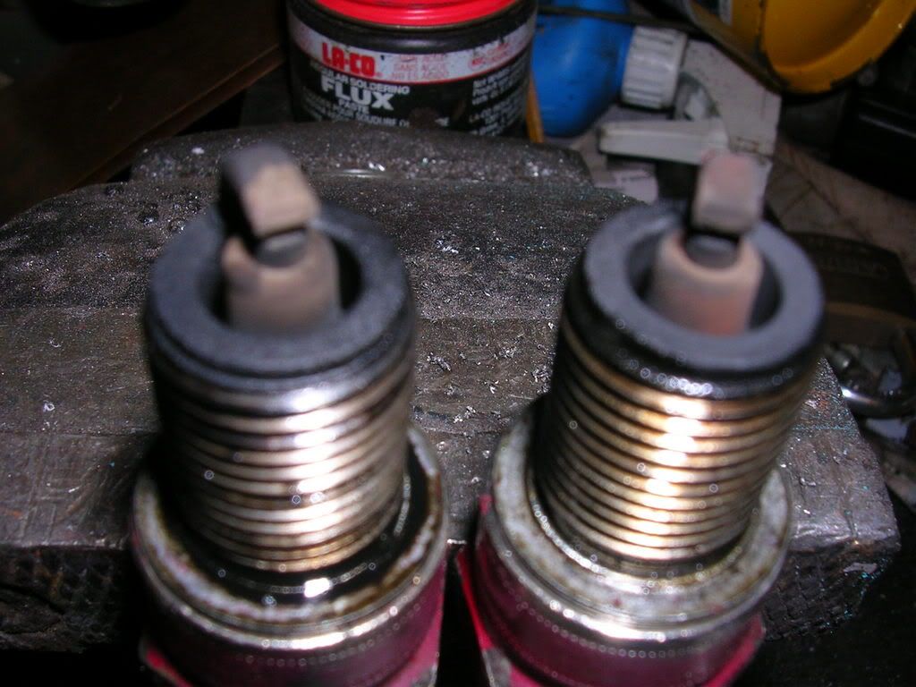

here are some pics of my plugs
These are my B8EGV race plugs note the smallelectrode, running a bit oily and rich but better rich than lean especially with turbo, see one on the left has a melted electrode (missing) i think i had the timing a little to far advanced oops :oops:.

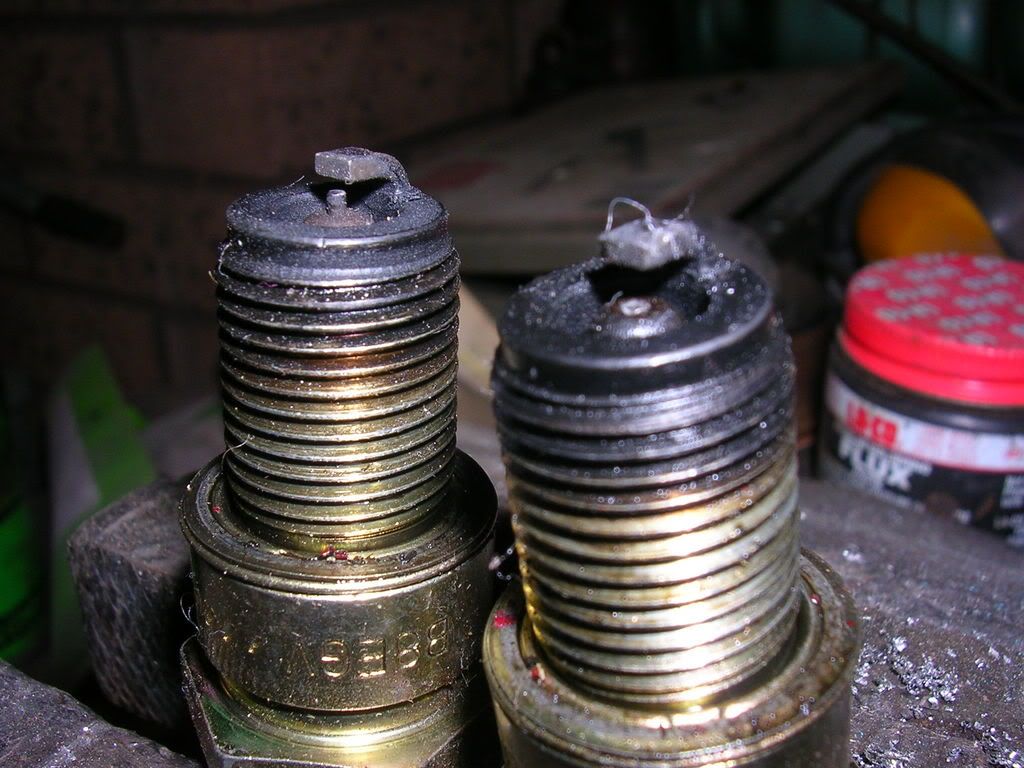

and these are the BP8ES STD plugs.

Centre electrode on RH one in 1st pic looks a bit suss... :shock:
2nd pic ones look OK to me. :wink:
