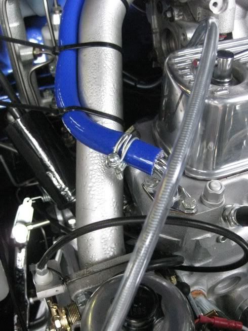

I haven't connected the heater element as I find it difficult to believe it will make much difference, but I will try at the weekend.
The main cause of the moisture is the extreme cold of the inlet pipe and a little heater element at the start will only heat the incoming air slightly.
I am yet to be convinced. :?

I connected the heater element in the air cleaner and yes it gets hot but not sure if it works to reduce the humidity or condensation on the inlet tube?
Yes the engine is idling in this photo, I guess I need to learn how to take a video with my camera?
I guess I need to find a plan B?
I have been advised that the condensation is only a worry when the humidity is above 80%. I guess they dont reach that level in the UK :?:
I need to get this issue resolved cause the engine goes so well, I just want to take it for a long drive and not worry about this issue.

Just beacause there is condensation on the outside doesn't mean the pipe is icing up inside...
I'd not worry at all, unless you get other symptoms. eg. when an SU ices up the throttle jams partly open.. I found this out in the highlands of Tassie one damp day. Weird feeling... :?

Hey Doc, Getting condensation on the inside which runs back down into the carby bridge area. No problem while acelerating but causes hesitaion and stalling when taking off from the lights, if stopped in traffic.
