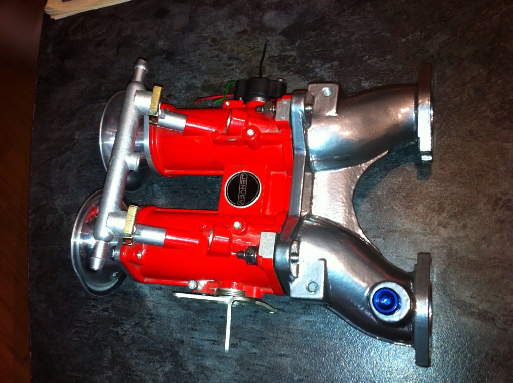

This is what i am about to tune now

im using a HAltech F9 at the moment its fuel only so ignition is controlled by the standard electrinic dizzy ..
now looking to upgrade to a later E6X so i can have spark too
i have played a little with 5 port injection and one common theme is that the A series motor doesnt like too finer fuel droplets ..
my first injestion setup
ran S4 RX7 injectors which are like a big hose ..
This was it running my first set up
not tuned first time running 1293 huge head and a kent 296 cam
i am now using ecotec V6 injectors in the Jenvey
injection is in NO WAY easier than a weber .. but it is rewarding and worth the challange
