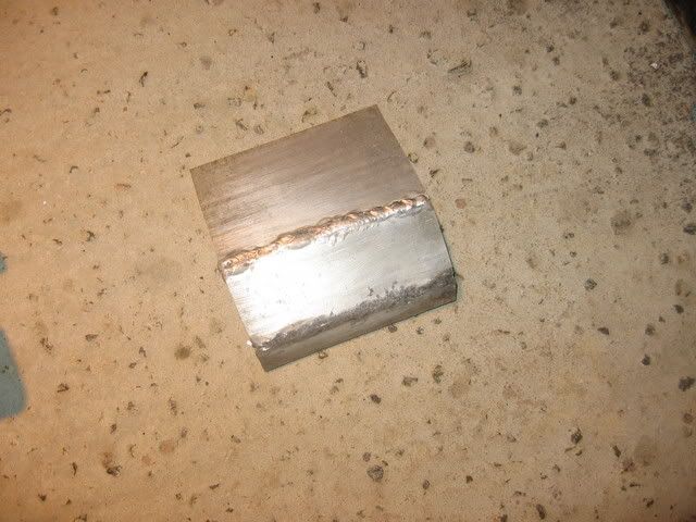

anyway a bit of an update hadnt done much this week as i was waiting for my carbide burrs to arrive so i could grind the inside of the pipe as i went along. They finally came today so managed to get a little more done.
also had a little play with my tig tday and managed to weld some alluminium without it melting into a ball :)
