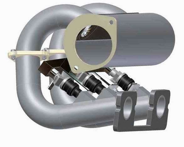

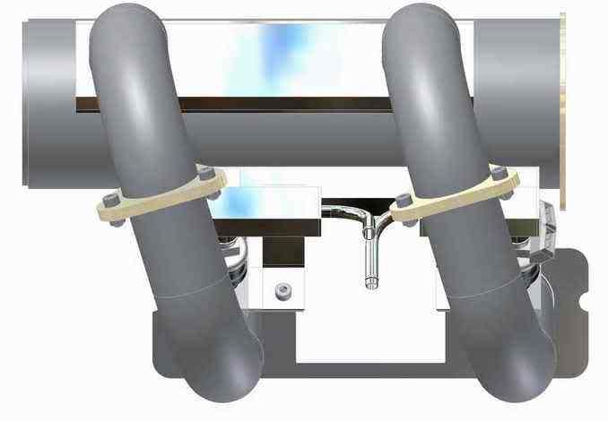

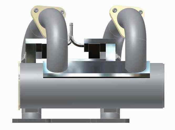

The manifold possibilities are endless with EFI. I made one to this design:
This design uses 4 Bosch 14 mm injectors as per N13 Pulsar. It uses Pulsar fuel rail sections welded together and fits a VN Commodore 60 mm throttle body.
It looks like this installed (if only my fabrication skills weren't crud :oops: ):
The runners at the head are 38 mm outside diameter. They taper up to 41mm and all of the bends are 41 mm stock mandrel bends from Fleetguard.
Runner length is 415 mm or over 16 inches each, not including the plenum.
Top half lifts off for access to injectors. The exhaust system must be made so the 1 & 4 pipes drop vertical prior to angling in so they miss the lower pipes.
Anyone need a manifold designed for their turbo / supercharger installation or if you want dual throttles etc. let me know & I can design it up & send you the drawings.

PostPosted: Sun Dec 31, 2006 11:14 am
Posts: 4031
I may have seen dyno info on this before?? But if you have dynoed it what was the result? How does it drive and how much advantage is there over a carby?
Everytime I think about it, and look at all the toyota 4GZE stuff I got the more I want to make that work on a mini. BTW Mokesta, your fabrication skills mustn't be too bad as looking at that pic it looks bling!

Nah, the dyno results for Mokesta are for her with a HIF44 carb on modified stock inlet manifold. The manifold above vas designed & built in 2004 and has never been completed or used.
Lessons I learnt from making this manifold / going through this project:
1/ Never use a gassless MIG on thin sections, like mandrel bends being butt-welded. The slag comes out of the welds when you sand-blast and you are left with non-air-tight manifold...
2/ It's cheap to make the entire thing yourself out of mild steel but cheaper in the long run to buy stainless so you don't have to coat it inside & out. Again, you need a better welder than mine to weld stainless.
3/ Never make your own injector bosses out of 25 square bar and a cheap drill press. Spend the extra and get some turned up to the right 13.5 mm inside diameter. That way the injectors will seal and the spray pattern wll be better inside the manifold.
4/ Cars at the wreckers seem to either have 40 to 44 mm throttle bodies or 60 mm +. It's very hard to get the ideal size for a mini.
5/ Read up about 5 port injection before building a manifold. That way you don't end up with a manifold in a box in your garage because you don't want to spend $$$ on a decent sequential injection computer with individual injector opening phase and pulse width trim.
6/ If you put an oxygen sensor into the exhaust, put it in the side opposite the fuel pump so, when you decide not to go for injection, you can go back to mechanical pump...
7/ You can use the late Rover SPI distributor housing with a Jaycar trigger (or other electronic dizzy arrangement with locked, or no advence) as your crank angle trigger. you can't use a crank sensor with sequential, you have to use a cam trigger. A crank trigger will give you #1 at TDC but not which stroke.
8/ To tune the thing on the dyno, you'll need exhaust gas temp probes in the outer and middle exhaust outlets, or two wide band oxygen sensors. It's the only accurate way to tell if 1 & 4 are the same mixture as 2 & 3.
9/ You can make a great fuel rail from bits picked up at the wreckers for next to nothing BUT... The rails on Pulsars/ Commodores (N13 & VN with Delco injection) are brazed together and when you get someone to TIG up your creation, the braze filler mixes with the TIG puddle and leaves micro cracks everywhere. The fuel rail looks sex but sprays fuel from every join... Get it brazed together and save the heartache.
Happy fabricating.
