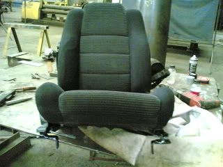

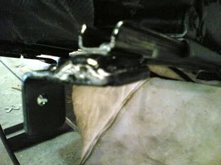

PostPosted: Fri Feb 17, 2006 9:05 am
Just welded a couple of lugs to the front of the mazda rails
to pick up the bolt holes on the standard mini seat brackets:
(headrest not shown)
No extra holes in the mini required :)
