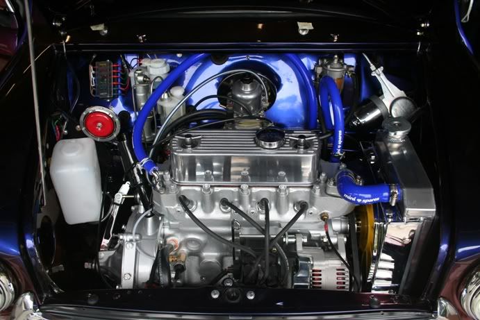

Engine almost ready for rego check.
Fingers crossed
Fingers crossed
there's something missing from that picture...
PostPosted: Thu Feb 02, 2012 1:06 pm
Posts: 3166
An oil leak :?: :shock:
