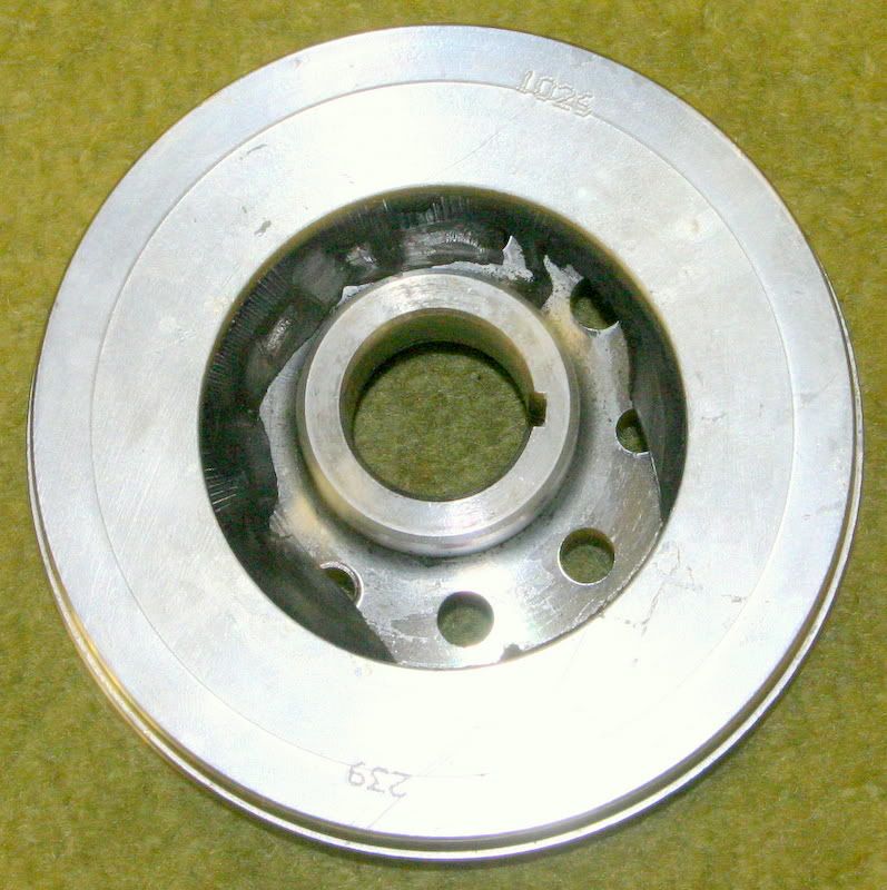

I have now seen a Romac off a 1275 race motor with the knurled rubber strip hanging out the side.. it was not a pretty sight. :shock:

mini7boy wrote:
I would like to hear from anyone who has had problems with Romac dampers on either road or race Mini engines. Thanks.
Hi mini7boy,
To answer your question, yes.
Graham Russell :)

Yep - mine looked pretty much like that.....

GR wrote:
Hi mini7boy,
Graham Russell :)
:shock: Fair effort that......
GR......
How long was it on the engine before it did that?
Did you pull the engine apart after you found this?
If you did pull it apart, were there any other problems that may have contributed to this happening?
Cheers Scott

Hi simon
The balancer was on for two meetings and no there was no
other damage to the engine.
When these balancers first hit the market we were one of the
first to use them, back then the outer ring kept parting company
with the inner ring so they then put the snap ring in the front to
stop this happening but they didnt fix the problem which is the
rubber between the inner ring and the outer ring.
Now in saying this there is another big problem its called the
driver,[ the guy behind the wheel] if youve ever stood at the end
of the straight at a circuit you see what i mean.
the arrive at the braking area , and as soon as they hit the
brakes they shove it back into third gear and let the clutch out
most of the time when there are no reves to match the down
change, and when the clutch is let out the reves go way beyond
any rev limiter this imposes a lot of load on the crankshaft
now the outer ring on the balancer wants to keep going when
the rest of the motor is trying to slow down and the rubber
can not handle this, nor can the centre main that why they
often brake.
You have to get your speed down before you change down,
BRAKES are for slowing the car down not the engine.
Now in saying all this i have used one of these balancers on
Greigs car when i first built his engine,but his engine is a short
stroke engine which changes a lot of the harmonics and
vibrations in the mini motor, in my motor being std stroke
ihave to run different valve springs, balancer, and flywheel
to Greig engine plus he does now how to brake and change
down gears.
Graham Russell
