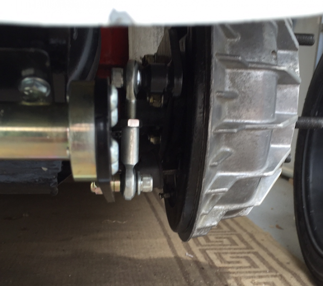

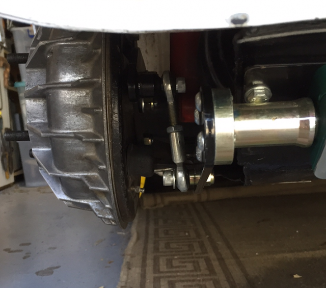

I have just fitted the above, all good except I am not sure the angles of the drop links are correct, they are vertical looking from side of mini but as you can see from rear, they are on quite an angle, slightly different each side.
Was thinking of making spacers up to set them straighter however i will require longer bolts due to having a spacer in there, which isn't a problem.
FYI - I have fitted the spacer provided in the kit
What do you guys think?

No comment on the fitting, namely because I don't know, however did this package come with a set of instruction? You may need to contact KAD, unless someone hopefully knows the answer.
One comment l will make, when getting new component parts ask for a set of instructions for an install.

As clr60 said, I can't comment on fitting either as I haven't fitted this brand either. Not having a go at your work but it could just be not fitted correctly, by that I mean not central. Sometimes you'll find you measure accurately from given points only to find they're not actually in right place. I'll explain better, this is just example, the instructions say to drill hole 50mm in from outer edge at a given point, you do this and according to the instructions the holes should be 900mm apart, you then measure it and they're actually 890mm.
What I'm getting at is the subframes are designed to have certain points, i.e. arm pivot points, mounting points, etc, in an exact position, all else is irrelavent.
The stampings are in some cases woefully inaccurate, have a look at different ones you'll see what I mean.
Anyway, back to your problem. Just do some measuring and insure bar mounts are central to the suspension arms, forget the frame, then 'tweek' the drop links to suit, the spherical rod ends will take care of the rest.

I'm not an expert, but i don't think that should be a problem.
There shouldn't be any sideways movement between the swaybar and the trailing arm so all that should happen is the spherical joints will move slightly front to back, but not side to side. So should all be good.
Just so long as the outer body of the joint is not hard up against anything or close to max angle.

Rod ends will not cope with high bending loads. These should be only in tension or compression. Any angle will induce bending loads, so it needs to be minimised.
Also you need to remove the springs and check the angles of everything through the whole motion of the swing arm. Only getting it right at full droop may cause problems once the suspension is loaded up with the full weight on it or when at full bump.

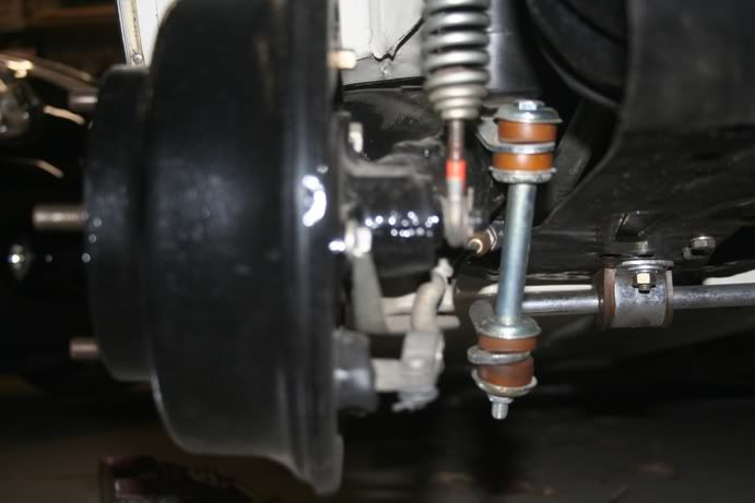

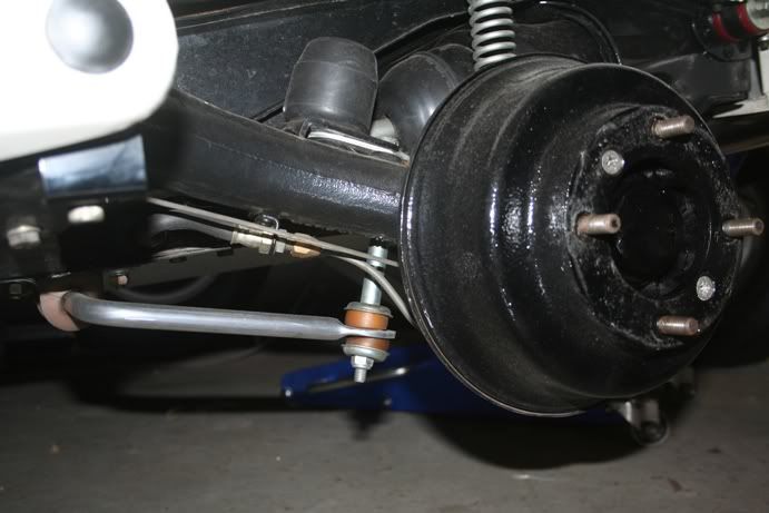

Here are some photos of my K Mac rear bar on Mk1 S with hydro, worked Ok for the past 40 years Image

just a heads up
Wait until you have the car on wheels on level ground before dialing in the endlinks. I have the same swaybar , and I believe they should be set dead flat vertical from the ground.

thanks all, I am still waiting for KAD to get back to me, I did set my droplinks when the car was on the ground at normal road height. I was thinking I could just put longer bolts in and spacers to get them more vertical (from the rear)
Also, the bar is only 2mm difference from left or right and as both droplinks are angled in, it wont make much difference if I move the bar left of right.
You can't induce a bending moment in a rod with pin joints at either end. The only way that drop link gets any bending loads is if the rod ends run out of angular travel. That doesn't look like it is happening in the photo shown but could occur at the extremes of motion. If the rod ends don't bind, I would just leave it as is.
