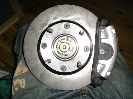

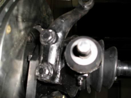

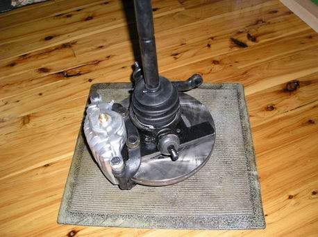

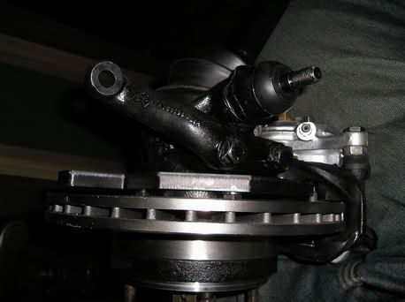

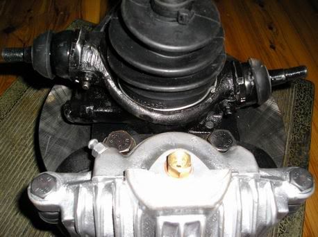

Here are some pics of the set i had made up.. Dont know if they will be any help to you..

cazmo wrote:
no the studs are in the flange
Sorry for all the questions.... So...
The studs stay in the flange as normal.
The rotor then is mounted behind the flange and i guess the back of the studs rest in the existing rotor stud holes as they are oversized.
Then you bolt together the drive flange and rotor with four bolts as in the pictures.
So the only mods you have to do is drill four new holes for the bolts and skim out the big hole in the middle of the rotor so it does not foul on the swivel hub.
And of course make a mounting bracket.
Am I on the right track???
