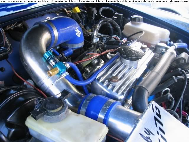

dynosheetorban... :wink:
Blue hoses do NOT add real HP. :lol:
If you want big HP and MPI, go get a 7 or 8 port head for starters.
