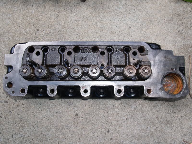

12g940 , 1275 (1100S) head that was on most non cooper s blocks (was on 1275gt with extra stud holes ???) , the normal one people use for a big bore motor . If you do a search for 12G940 there should be a lot of info on here about them , basically a good head and with a little bit of work can fit on a 998/1100 motor for really good breathing .

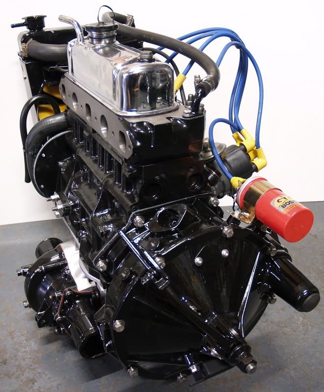

its on a rebored 1275

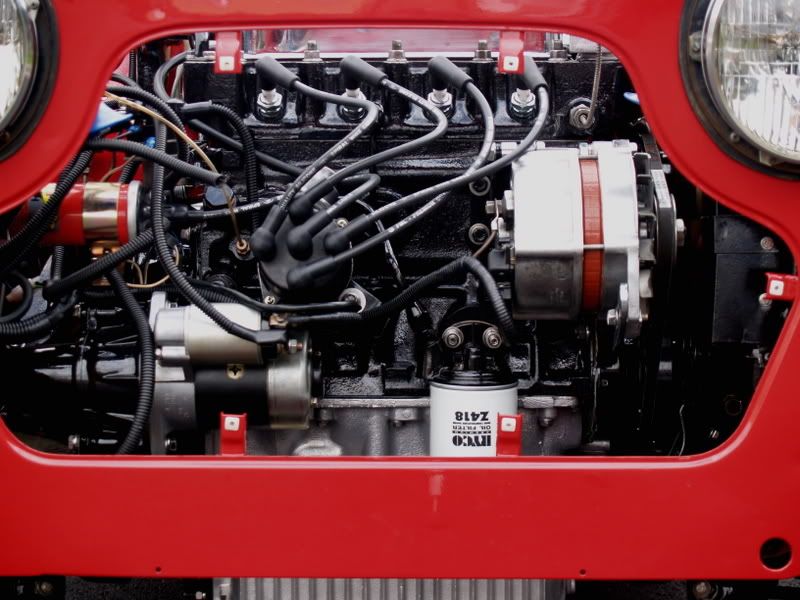

A+ series block?
PostPosted: Mon Oct 09, 2006 8:43 am
Posts: 39752
Hard to tell if A+ from that angle, if dizzy held in with forked clamp and 1 bolt, and there are webs on outside of block, yes it is A+.
Like this one-

Can you tell from this angle?
PostPosted: Mon Oct 09, 2006 12:09 pm
Posts: 39752
Yes, it's A+, you can tell by the position of the 2 rear bracket bolts that hold the alternator. Same as in my pic. :wink:
On an A series they are a few inches further away (originally were for a generator).
PostPosted: Mon Oct 09, 2006 12:12 pm
Very VERY shiny motor!
Looks awesome.
Was almost every bit on it painted separately before assembly?
