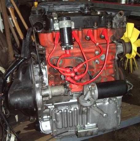

Here is an Auto A+ (belonging to Brickworx) Ignore the auto stuff like box and oil filter placement and oil pipe and you can see teh block shape and alternator mounts.
M

<edit> Here's a pic of my A+ showing the dizzy clamp setup, you can see the block ribs too. Dizzy is a Nissan Pulsar D4R83 with A+ drive dog, and 10 secs extra filing for the clamp to fit. 8)
