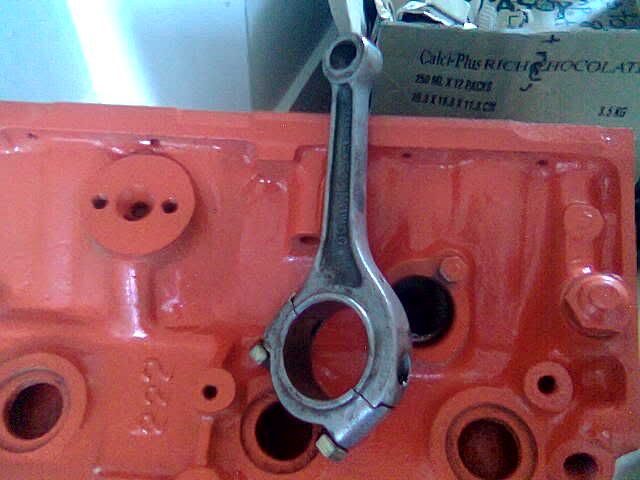

this is a pic of my bore/piston.
this is one of my rods
Engine is undergoing assembely atm....
1098 block, offset bored to 68mm
Hilman imp pistons
lightend/balanced/shot peened rods
010/010 crank
cam to be decided (have one stamped 8m73 which i will prob use)
cleaned up metro inlet manif, strobberg cd175 or su hs4(to be decided)
dont know how it will all go, but hoping for the best, id like to see 60bhp at the engine...
[/img]
PostPosted: Sat Apr 29, 2006 5:32 pm
Posts: 1943
sorry, pics takin with phone, make the face of the block and pistons look like crap, they are slightly cleaner than they look!

Been there, done that- 3 times, and 1st one (mine) revved to 8500 with a 544 cam and 12G940 head.
Please fit PTFE buttons to retain gudgeon pins, not circlips, if you're going for the big rev... :lol: :?

itll have a 940 head, just standard but recond. (has lotsa meat left as pistons come right to top of bores...seriously decked)
going for the torque with this one, dont want to rev too far and brake a crank :)
