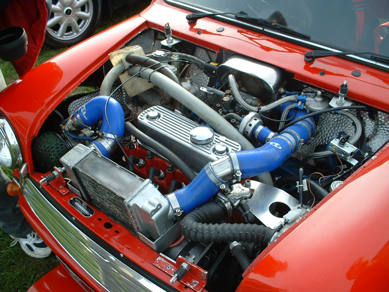

i think a good read of this is in order...
crazy Jamaica mini peope :P
http://www.turbominis.co.uk/forums/inde ... t&tid=1907

http://www.theminiforum.co.uk/forums/in ... opic=14297
sorry bout the pic size dunno how to shrink it :?

found this too janspeed turbo setup:)
http://www.theminiforum.co.uk/forums/in ... opic=13857
PostPosted: Wed Nov 02, 2005 12:57 pm
Posts: 11847
proper british peformance...
simple design, solid construction, pre-rusted parts.. :P
