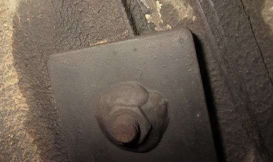

PostPosted: Mon Oct 03, 2005 11:01 pm
Pics of the retaining plate..
