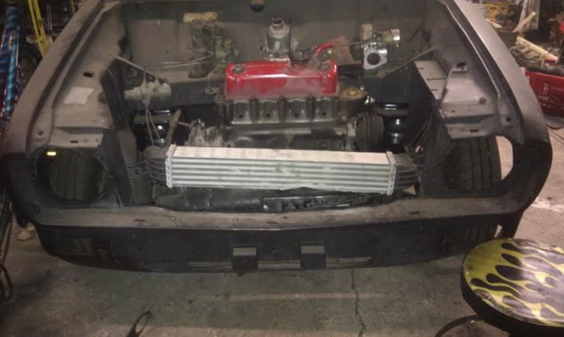

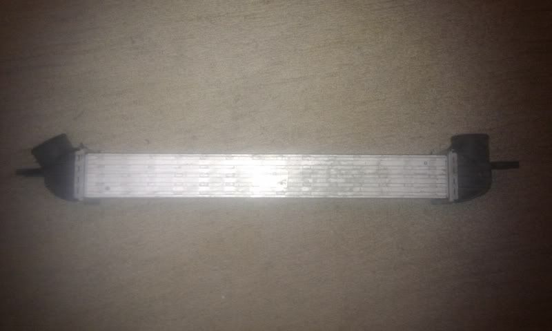

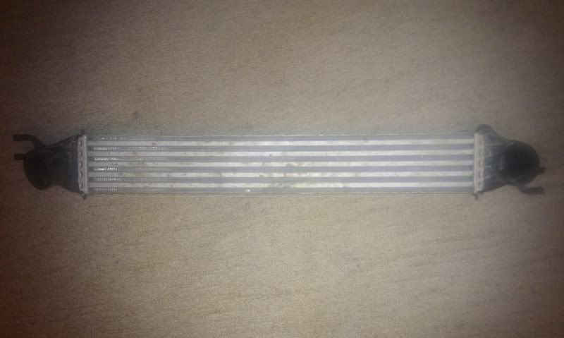

hey i have one that i scored from work, its a bit long i will need to get it shortened to make sure it fits where i want it but this is what it looks like.
hole length is 770mm (bracket to bracket)
hole height is 100mm (where core connects to plastic ends is the biggest)
hole width is 120mm (on the end tank)
core length is 540mm
core height is 85mm
core width is 65mm
inlet and outlet diameter is 55mm or 2"
PostPosted: Thu Sep 16, 2010 12:47 am
Posts: 2002
Looks like an interesting project xplosion. Are you planning on running a turbo with megajolt? Doesnt look like to much room behind that intercooler.

PostPosted: Thu Sep 16, 2010 6:42 pm
Joined: Mon Dec 20, 2004 5:16 pm
Posts: 92
yeah it will be interesting when its finnished but that will be very far away, its always about the money and time. i want to run it with the megajolt system, it sounds like a good setup and very adjustable as well.
ill see how i go with the intercooler i only think it may need to be shortened a little, i would like to mount it under the number plate but its all about the room and the direction of the inlet and outlet at the moment.
