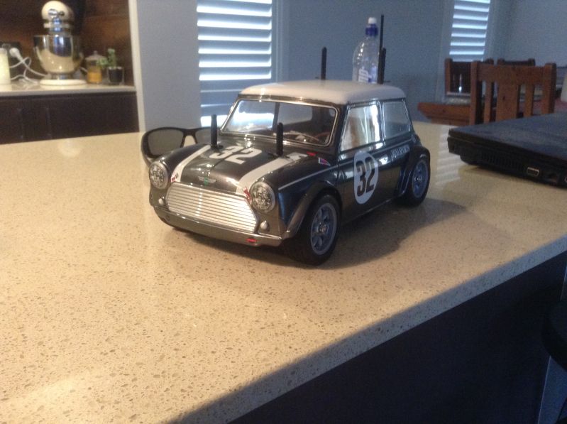

does look nice - a guy in the local club here loaned me his m05 celica in a similar colour to race at night under lights and it was very hard on the eyes, but yours should be OK with the white roof. I put stripes on it with stripy yellow/green electrical tape so I could see it better

And whether or not you want to upgrade to a brushless motor, then LiPo batteries, anyway, I love that silver. Great shade in my opinion.
