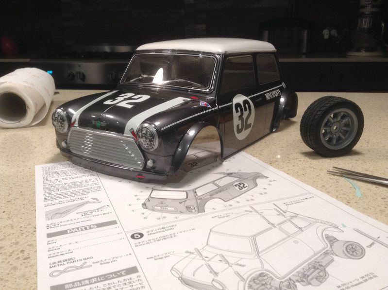

Board this arvo and decided to crack on with the body work whilst l wait for my parts to arrive from hk.
Happy with the result, it was fun to do this, last time was maybe 12 years ago
Gunmetal grey
Pearl white
Bright silver

Looks great!

Is that tamiya paint Dave?
Yep all 3 colours are Tamiya
