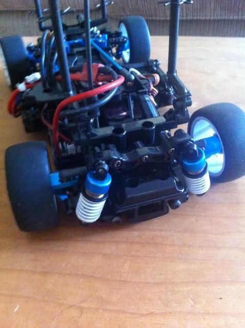

For those playing at home, here is my M05 as it come off the track last Sunday.
A keen observer will see that the front alloy shock stay is a bit bent (I will bend it back flat), rear left lower shock ball is missing its spacer to bring the shock completely vertical (as the arm is worn too much in the thread, and therefor pulled the ball stud out, but fixed for the last final on Sunday by using a long stud with no spacer), the ride height adjusters are red and from my Spec-R touring car shocks (which are a copy of Tamiya shocks - I measured all the bits with my digital calipers and can rebuild with Tamiya rebuild kits YES!) and it's generally mostly worn out.

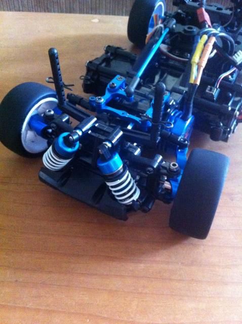

Here is mine for comparison. You can see that Scott is running an aluminium (bent) front shock tower which allows him to put the shocks more vertical.
You can see that I am running alloy rear hubs that increase the toe in by 2deg. I'm also using adjustable arms to control the camber.
At the front I also run alloy hubs. I will soon be adding the shock tower and camber adjusters.
The alloy steering links area big improvement but need shimming to remove the slop.
Some other upgrades you can't see are an oil gear diff and harder plastic gears and full ball bearings.
