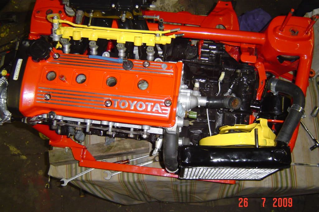

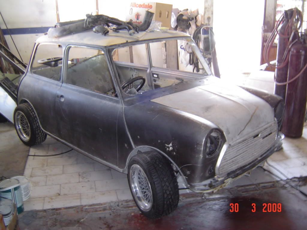

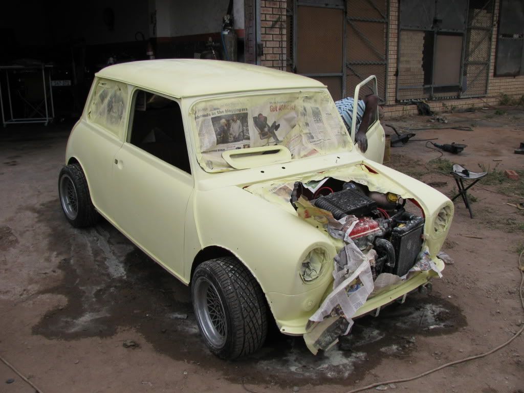

My name is Anand and I'm from Durban, South Africa. I'm currently building a round nose mini with a Toyota Starlet 4EFTE motor.
I started the project just over two years ago with a friend of mine.

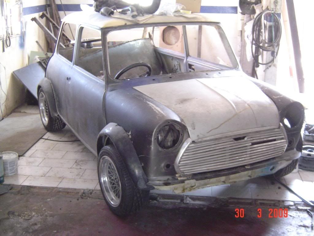

This is what the car looked like when I bought it.
I'm hoping to finish the car off by 15 May 2011, fingers crossed.

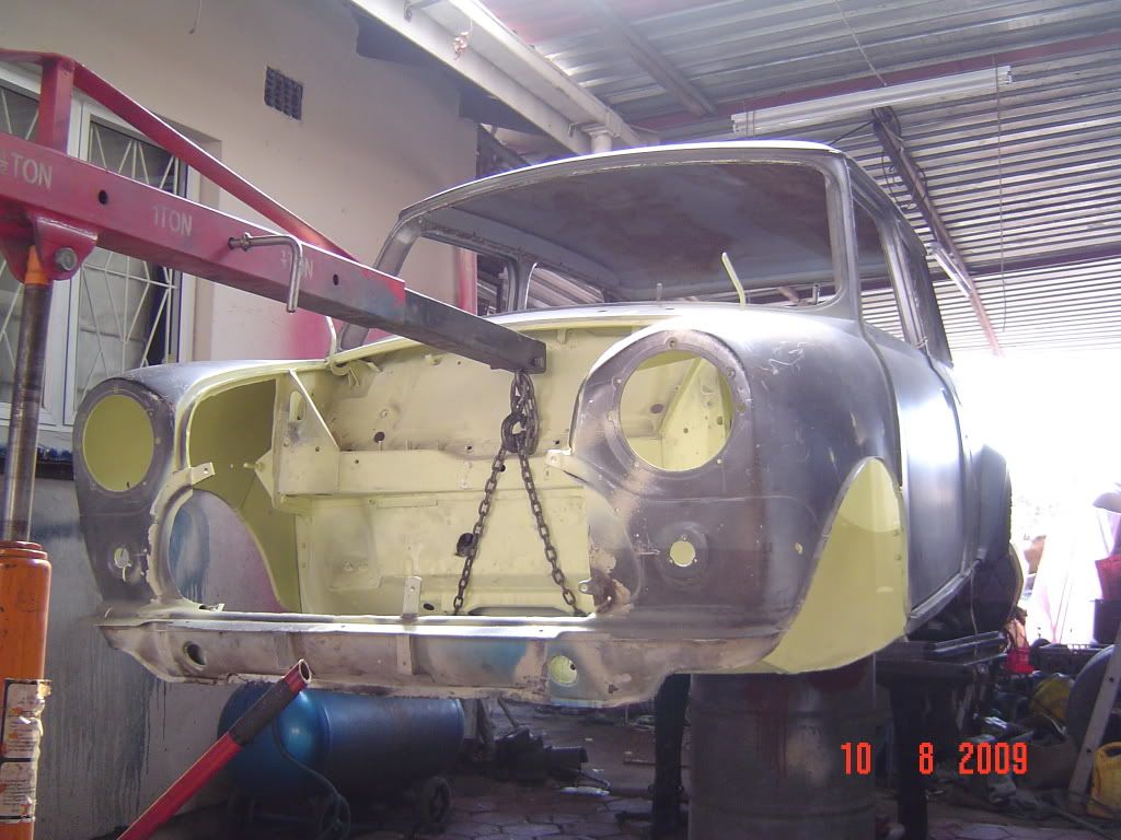

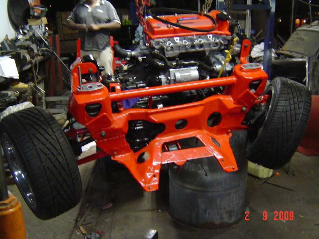

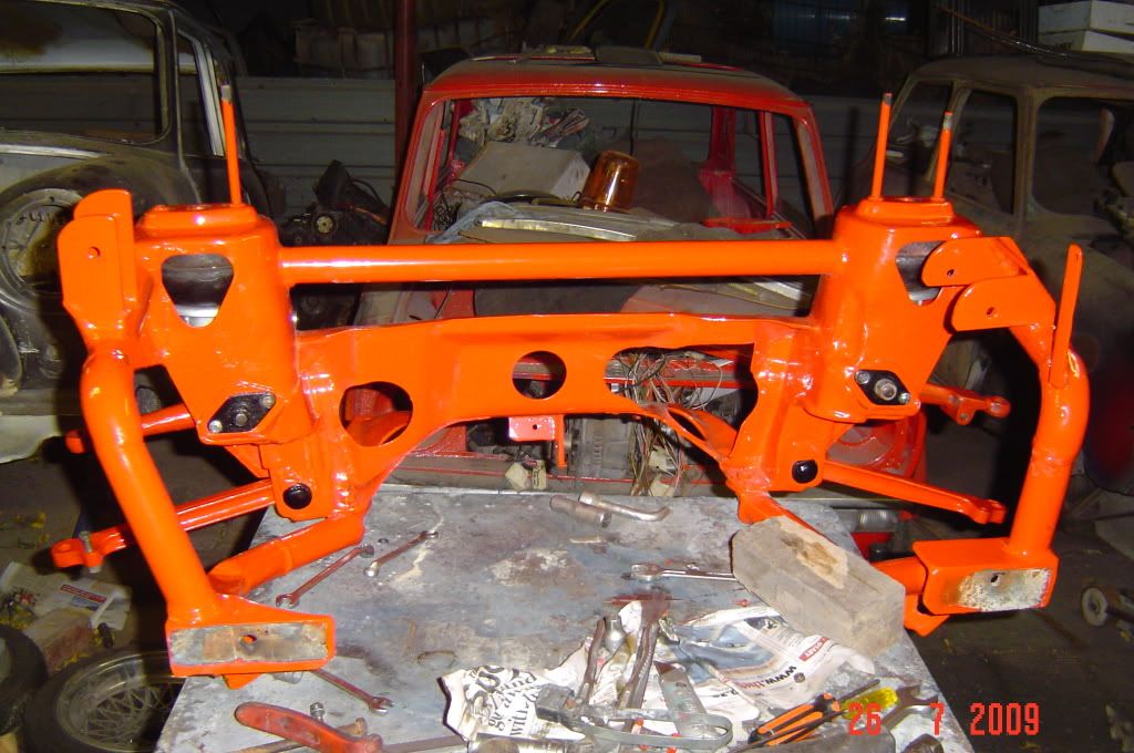

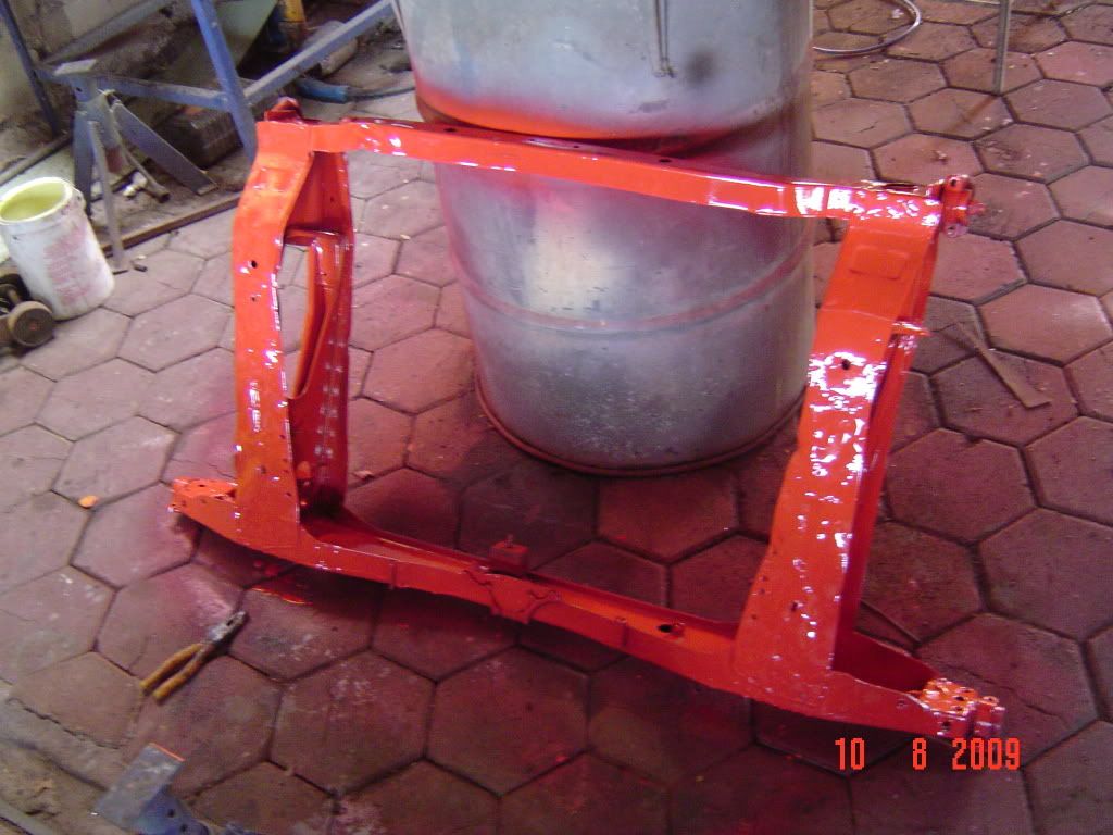

My frame that we built.
Engine parts going to powder coating

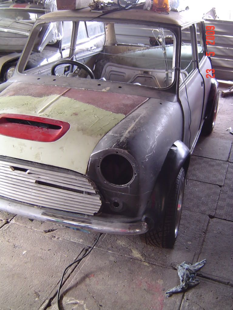

Experimental bonnet with the new mini cooper S scoop

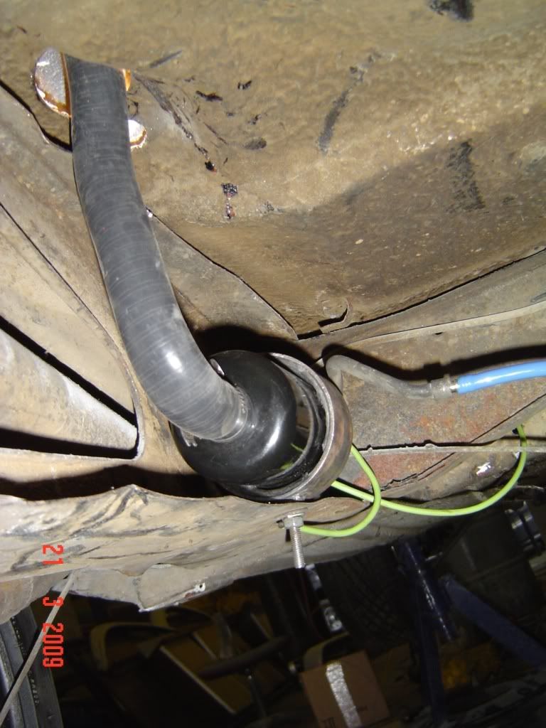

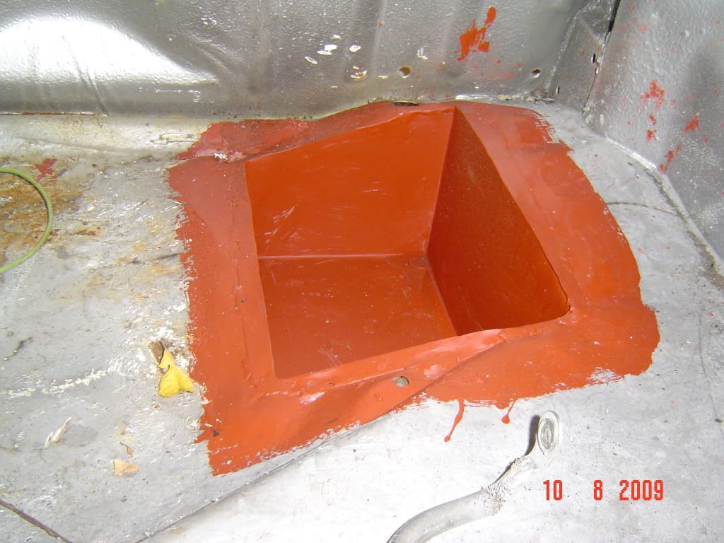

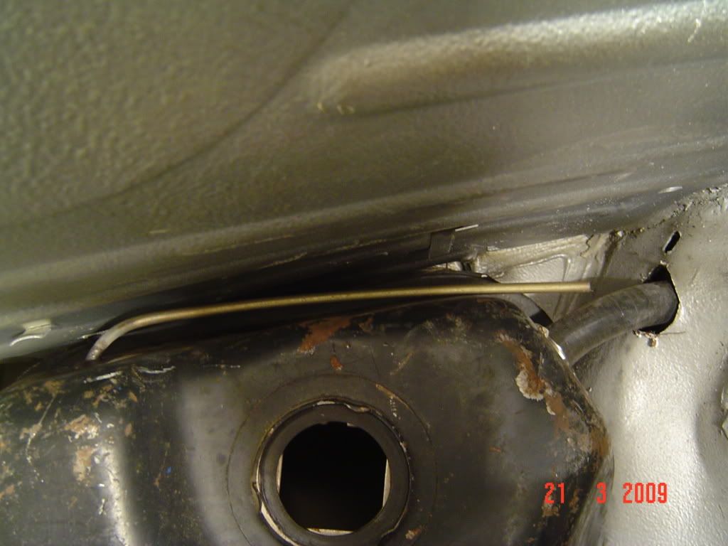

Fuel tank with gravity feed
VW golf fuel pump mounted under car

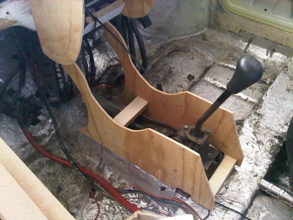

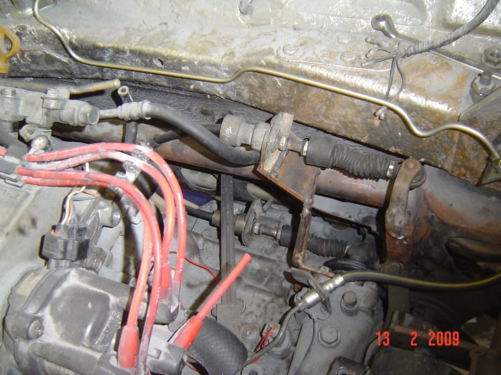

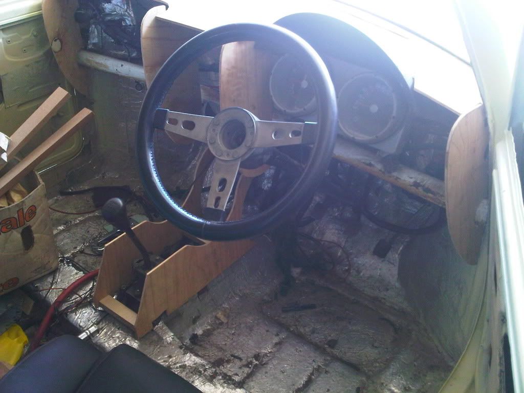

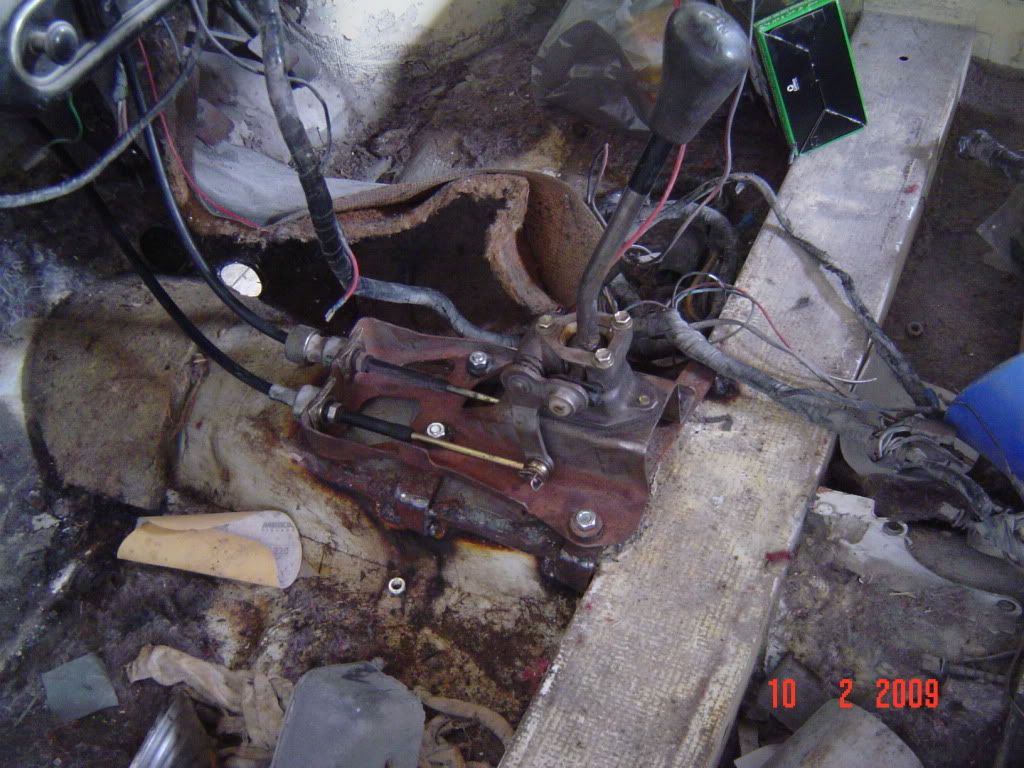

Shift cables installed
Gear lever mounted!!

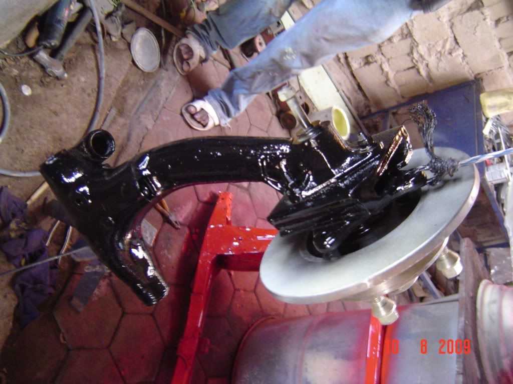

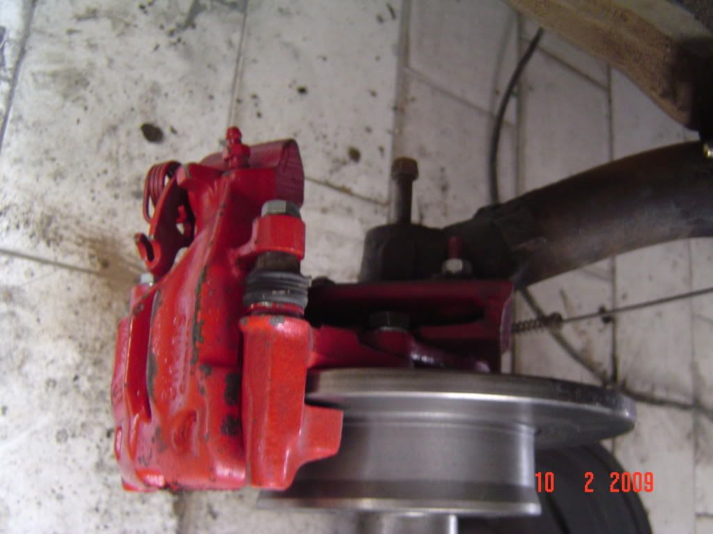

VW golf 2 discs at rear

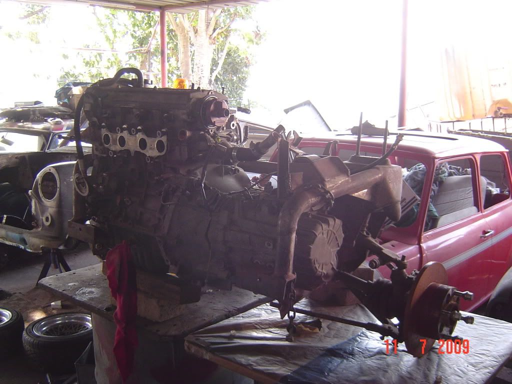

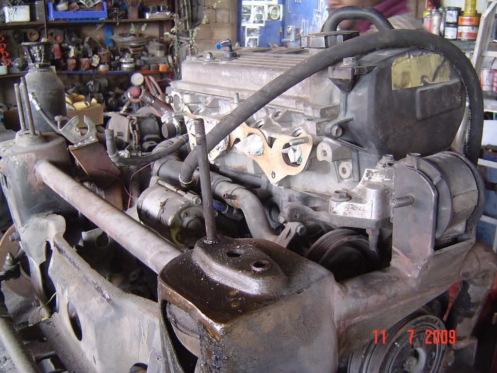

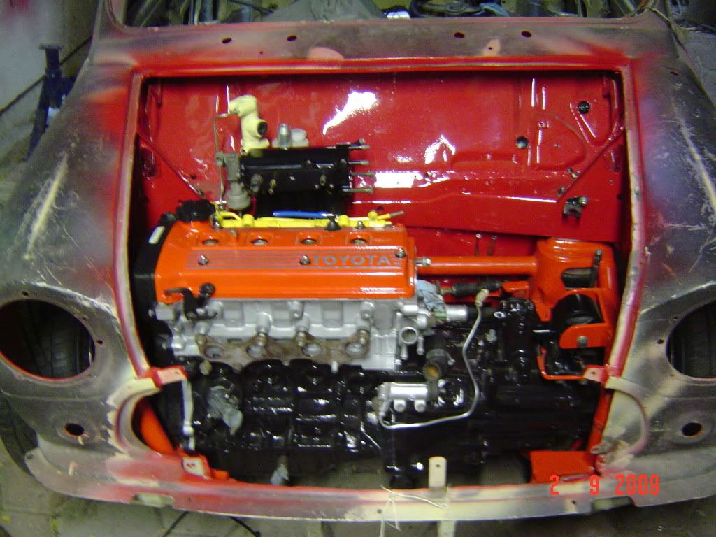

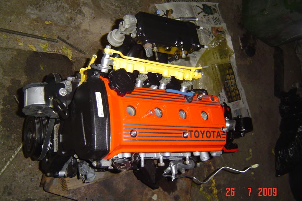

Engine painted and ready to be mounted

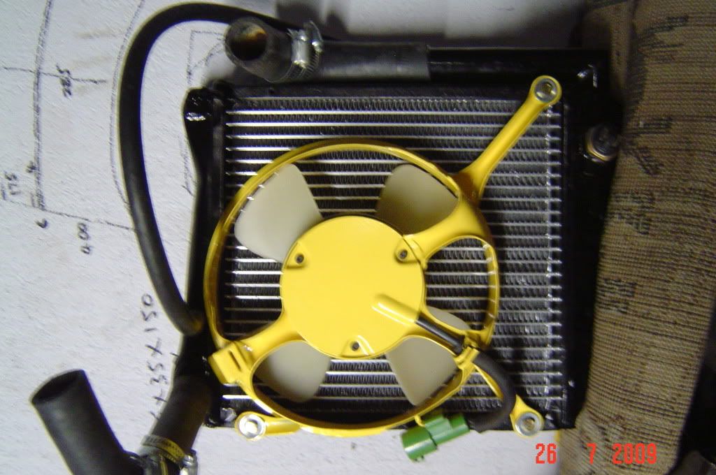

3 Core Radiator with Honda Prelude fan

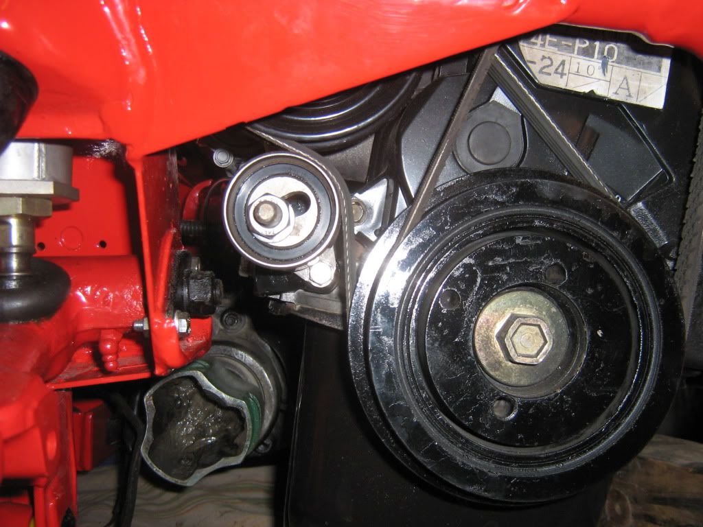

Tensioner made for fan belt

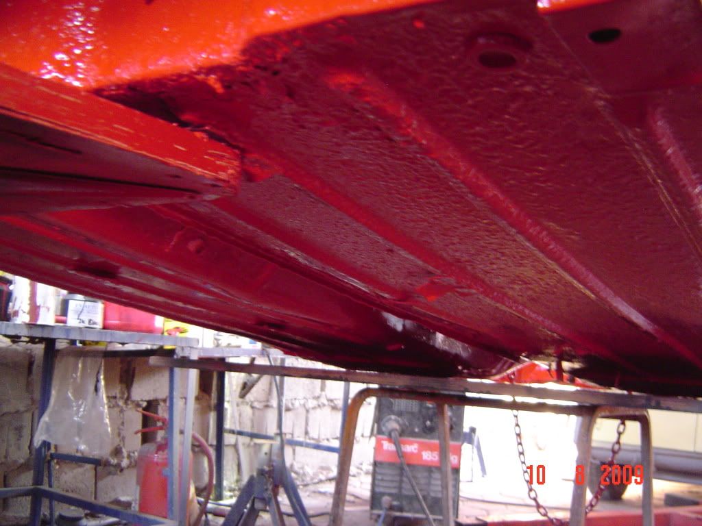

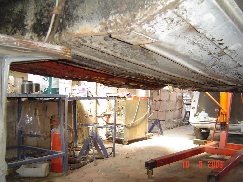

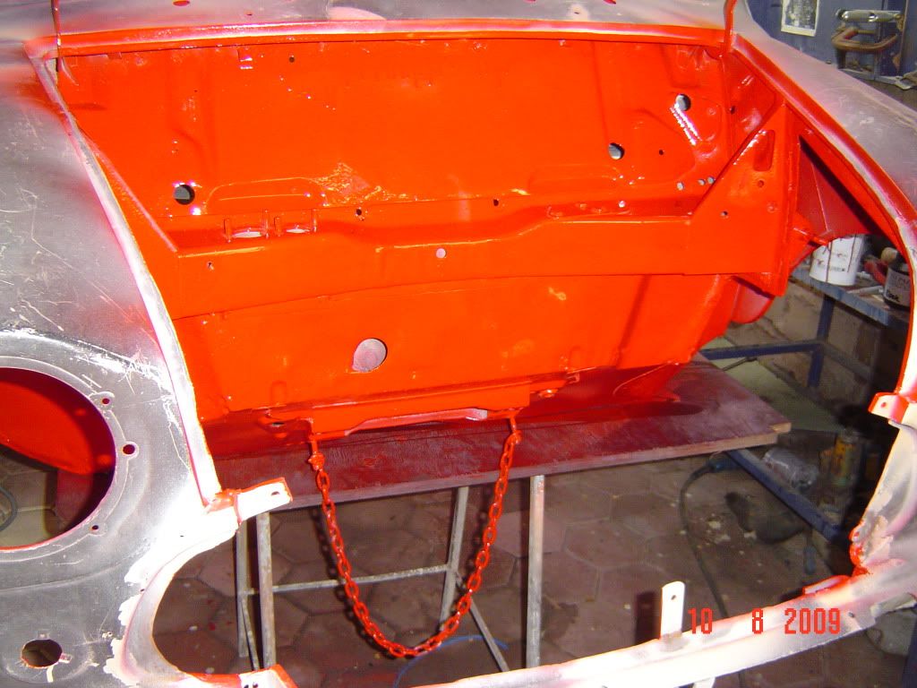

Under carriage, engine bay, boot stripped and painted
New battery box
Rear subframe painted
Rear control arms

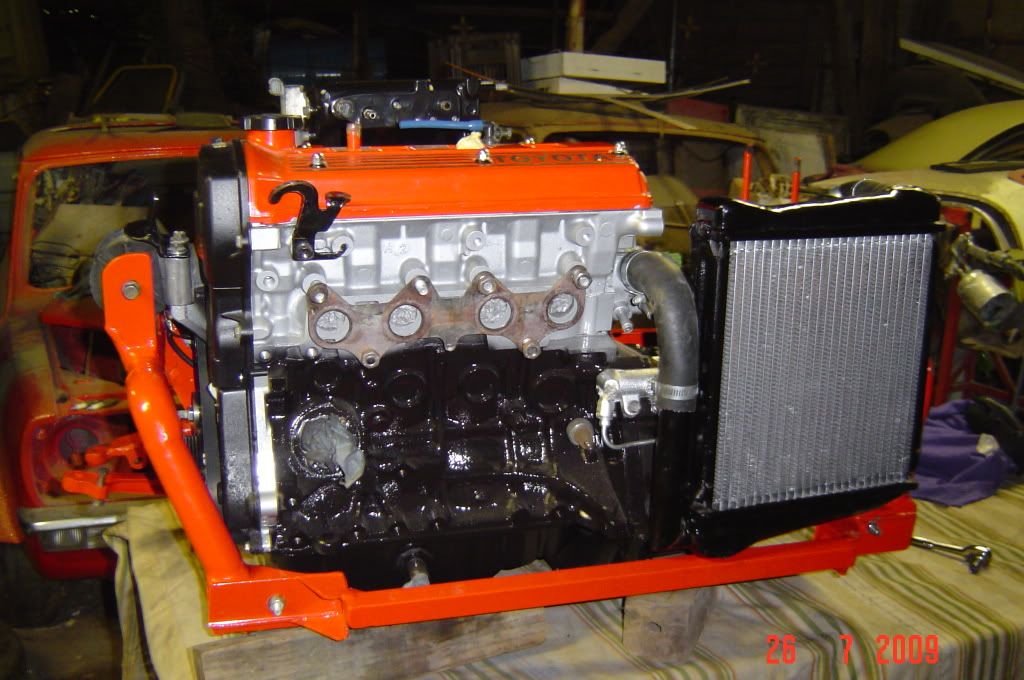

Motor ready to go in

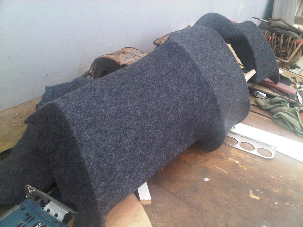

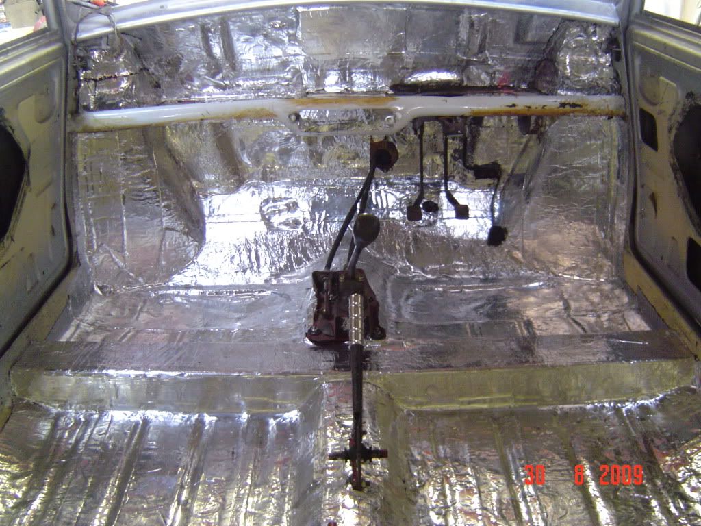

Interior sound proofed
VW polo cluster

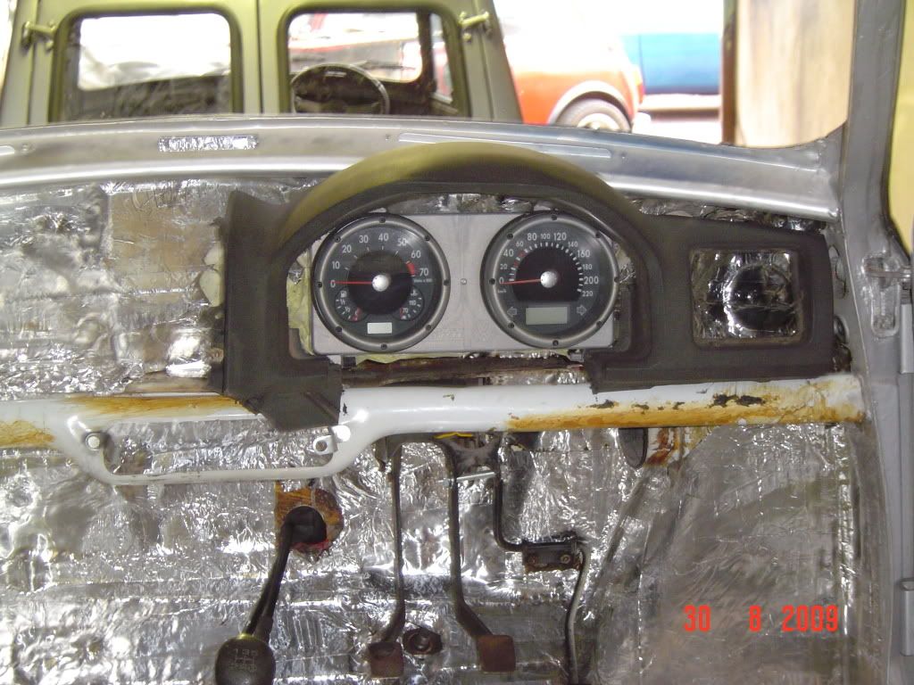

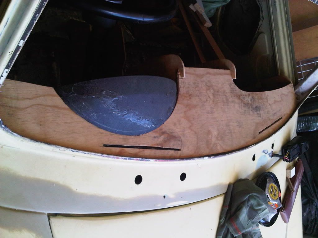

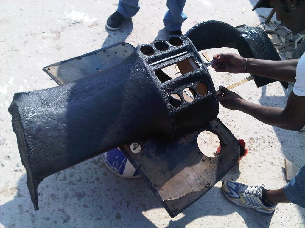

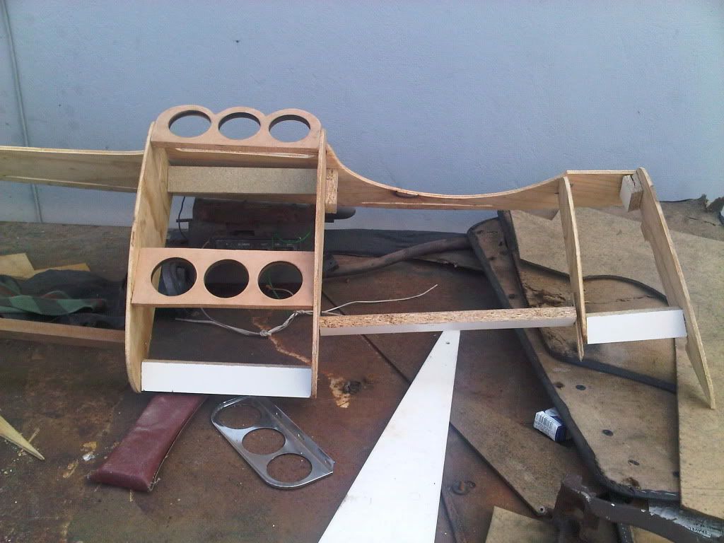

Custom Dash being built

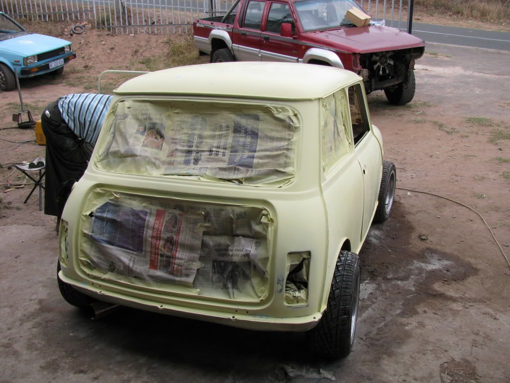

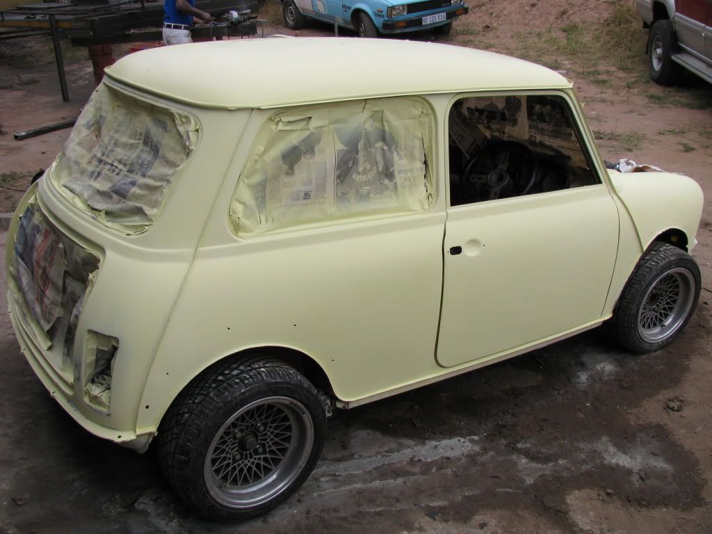

Car primered

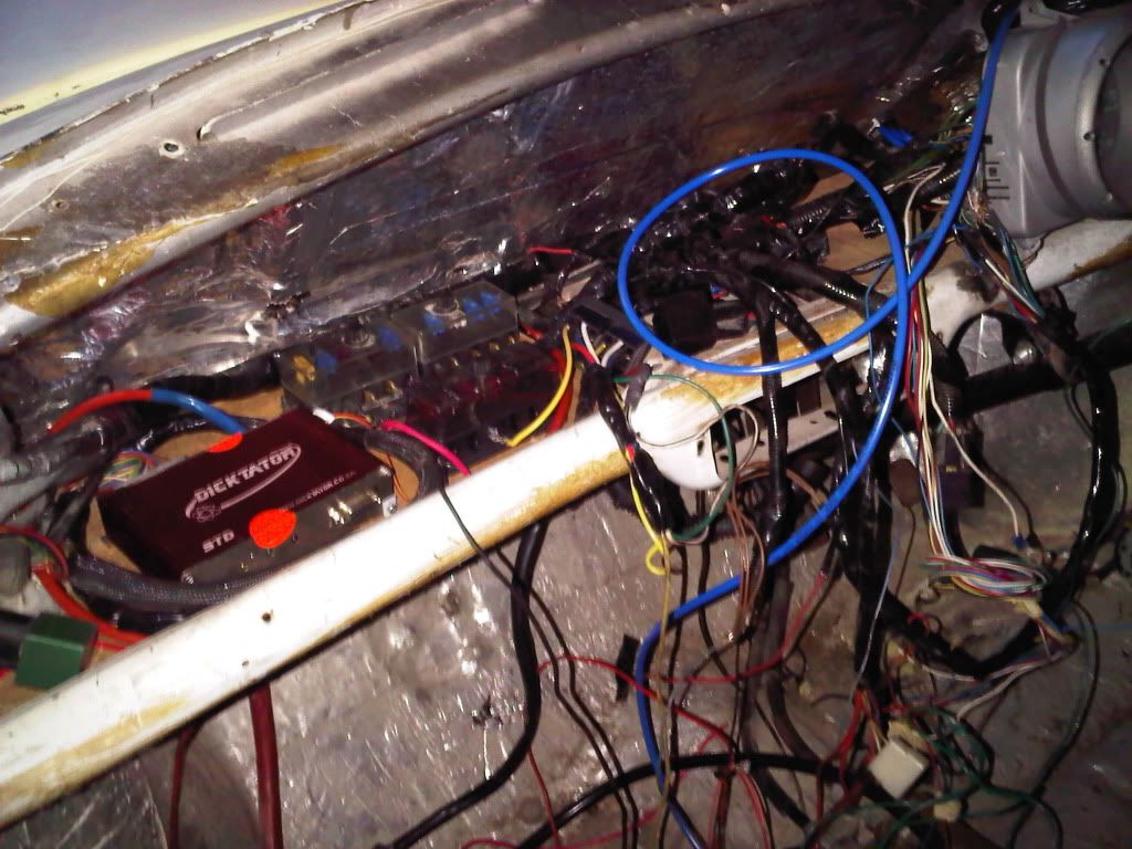

Engine management and fuse boxes mounted

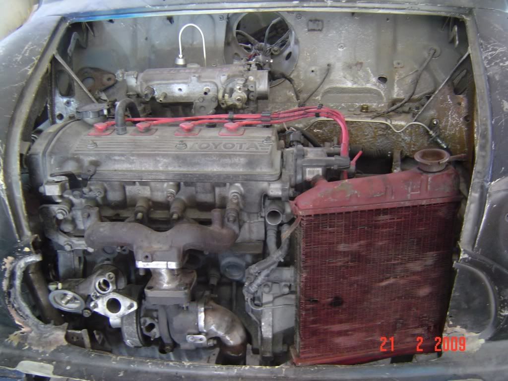

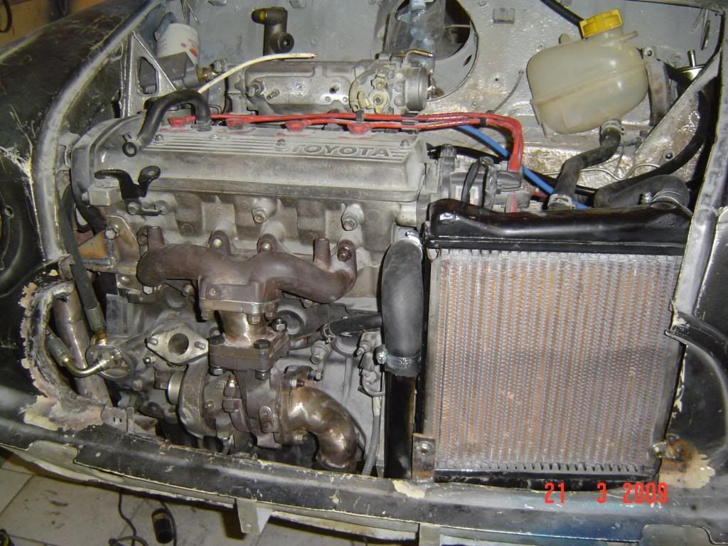

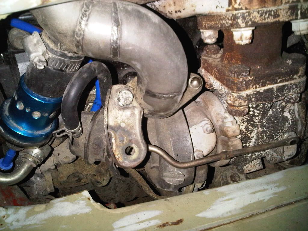

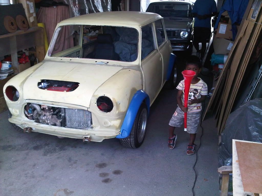

This build looks really good - nice work! Had to get a vuvuzela in there didn't you!
Why is there an extension between the exhaust manifold and the turbo?

That is a very nice looking starlet mini. Love to see it painted, what colour are you going for :?:

Amos, which vuvuzela part are you referring to :lol: . Since the length of the engine compartment has not been modified, we lowered the turbo so we could get a bit more clearance from the grill.
Kennomini , I'm painting the car red with black roof. Very similar red used on the car already.

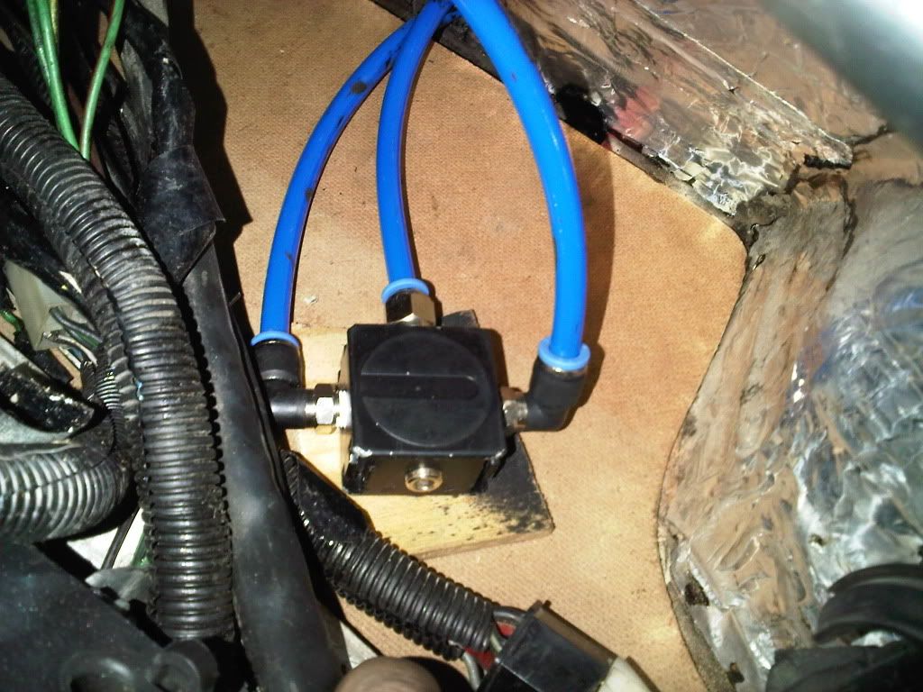

Can anyone who has knowledge of the starlet 4EFTE, tell me how the vacuum pipes for the actuator should be connected, if i don't have a solenoid anymore, i have a boost tap with one input and two outputs.
I have it connected like so:- vacuum pipe out of the turbo into 1st pipe of the actuator, out the 2nd pipe of the actuator into the boost tap, one output from tap vented to atmosphere and the other blanked off. I have my boost guage running vacuum from my intake and and my dump valve as well.
Note that i havn't driven my car as yet. When i rev it the actuator does not open the wastegate, is this a problem or will it work when i'm driving and the pressure builds up??

I love the work you doing specially with the dash awesome. By the way love the wheels too what are they?
I used to have a similar design on my Holden HQ as 14 inch
Since light travels faster than sound, people appear bright until you hear them speak
PostPosted: Sun Jul 17, 2011 6:00 pm
Posts: 2210
Location: Huon Valley, TAS
I think I want those wheels.
