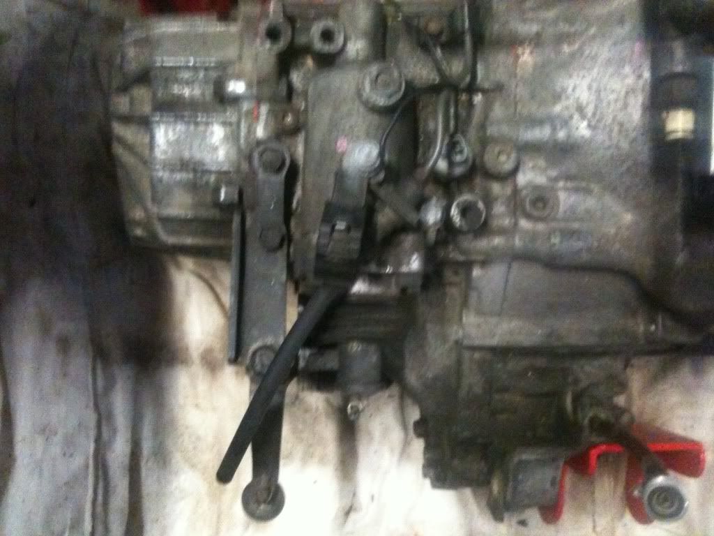

I was putting my 4efte into the subframe i got, courtesy of Tricky, and im having some clearance issues with the gear selector, due to the 6 speed manual ive got.
Can anyone tell/show me how other people have done to fit the gear selector?
Thats a pic of the one i have, and it sticks out to about level with the back engine mount.

Your gear selector arm will need modification.
Check out how Matt Power (Minstar) did his.

Joe there are few ways to tackle it as 92 has shown, I made a new bracket from scratch but unfortunately I don't have a pic of the finish product. Has been working well for 4 years...
Go here for a step by step...
http://www.mpdesign.id.au/engineconversion/conversion8.htm

Hmmm, its very good, and i think ive got a plan sorted to suss it out. I just need to find a bit of daylight time to look at things and do some chin scratching.
If it doesnt work out as i hope, im running coilovers so i can cut a pocket in the suspension tower and reinforce it inside.

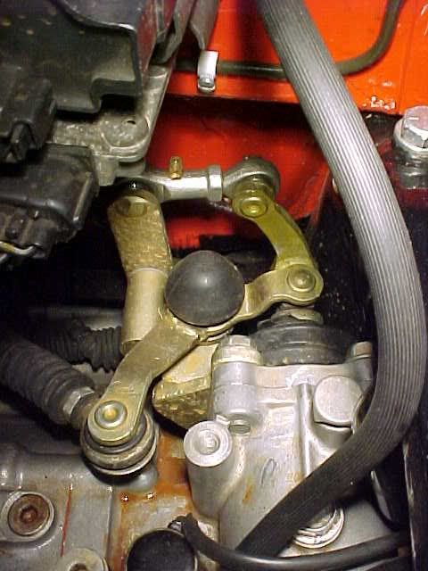

Thats matts (minstar) selector arm with the hole in the subframe.
I think my selector may be different as its a 6 speed. Ive got to get hold of a 5 speed for spares/comparisons.
