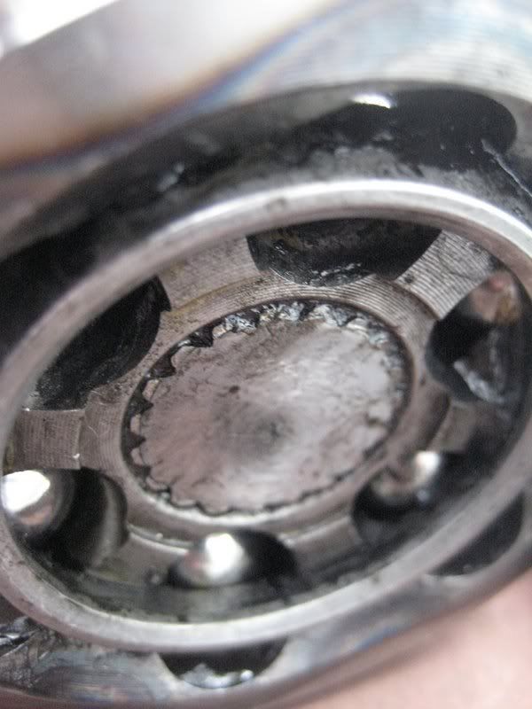

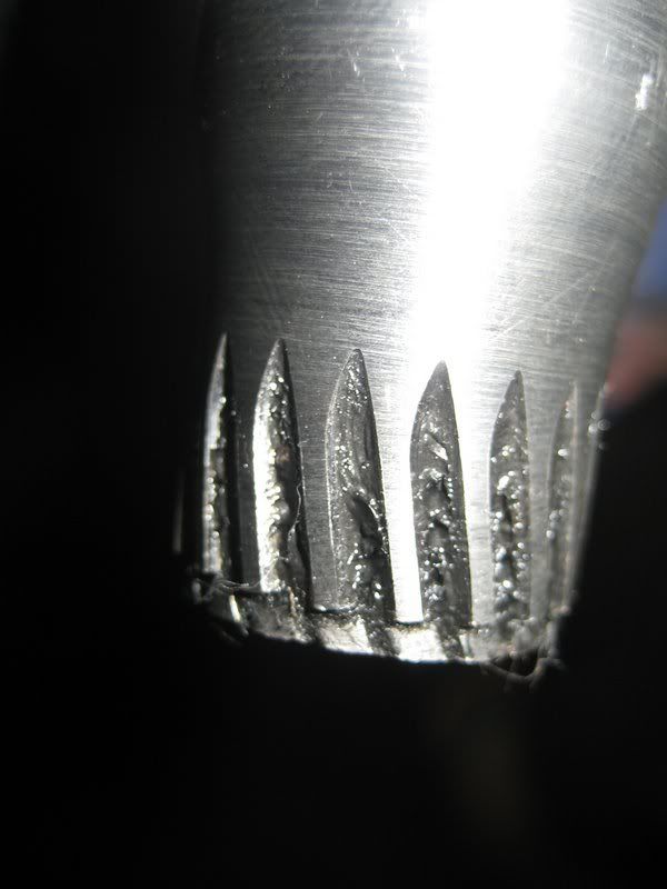

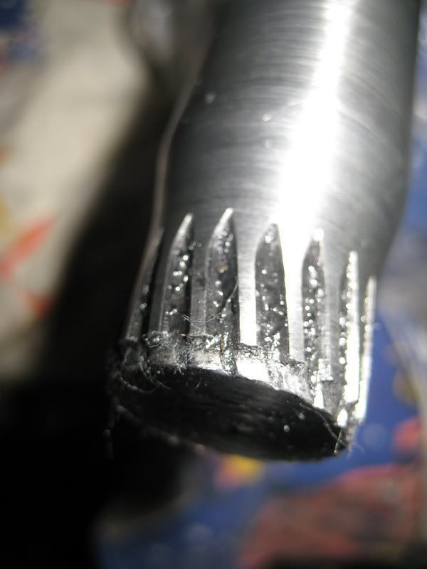

This time the other side :lol: (i replaced both last time with new billet ones)
GR tested these for hardness and they were 37 Rockwell. (Could have been harder but were OK) The first ones that broke were 55 Rockwell. (too hard and brittle.)

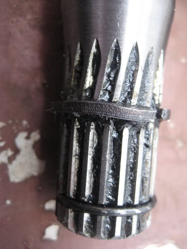

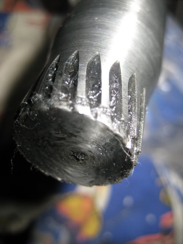

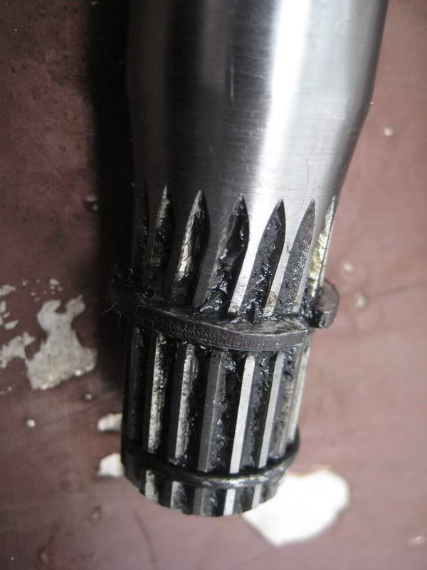

I was doing my third run at the drags and had it up ready to launch at 4000rpm and the new shaft just sheared completely at the inner circlip as i sat there on the start line. The shaft diameter needs to be smaller than the spline so the torque is transfered here and the shaft twists.
I took the shaft out from the otherside too (the short one broke this time) and the spline is already twisted on that side too. Nasty stuff!

I talk to anthony and see what he says, but i have been told by GR that is because the shaft is too thick and transfers all the load to the spline which is the weakest point where the circlip is.

The body of the shaft is too thick, it means that when you load up power, instead of the shaft twisting, it twists at the spline, this also locks it into the CV and can do weird things when suspension moves. All off road style race shafts have the shaft considerable thinner than the spline (usually thinner than the thickness of the splined section at the trough of the spline) this allows them to act a little like a torsion bar, and wind up a bit, reducing snatching loads.
