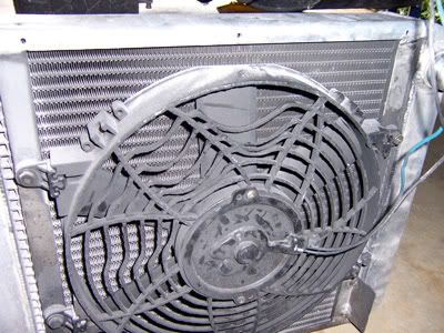

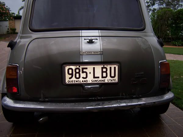

I took the mini out today to get some parts for my daily driver. About 10 k's from home I could smell something burning and this is what I was left with.
I am so lucky that a fire extinguisher was the first thing I bought after buying this car, hope this is a lesson for everyone. I am sure there is nothing worse than standing by while your pride a joy burns to the ground. Also a big thanks to the RACQ guys that towed the car home, I really appreciate their effort.

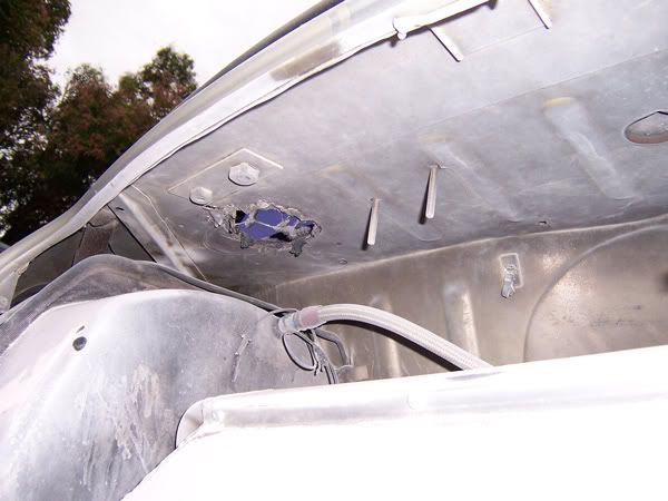

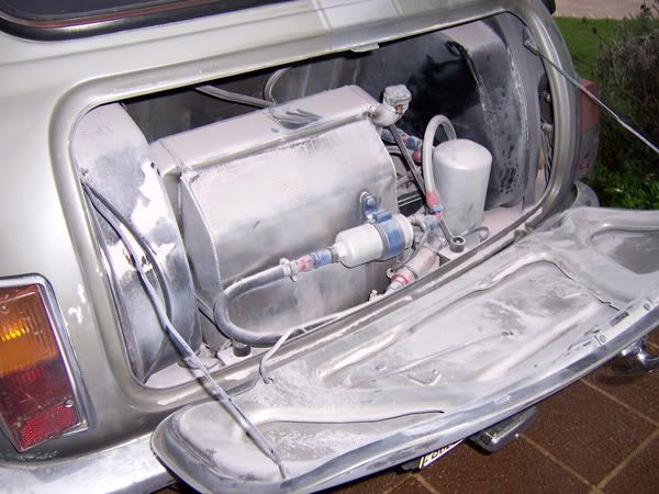

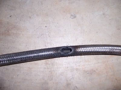

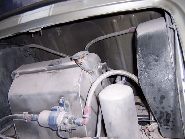

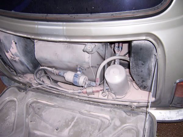

Well I finally got around to pulling everything out of the boot and have found the problem. It seems the balance line between the fuel tanks was rubbing on a bolt at the back of the boot and has worn a pretty big hole through the braided line. The fuel must have leaked through the radiator scoop in the floor and ignited on the exhaust. At least it shouldn't be too much effort to fix. Looks like the radiator fan has copped some damage from the fire as well. Anyway here are the pics...

The armour flex fuel line didn't seem to do you any favors. It may as well have been plain rubber.
Braided hoses I typically see in marine applications can be taken to with a tomahawk, and still perform their duties up to the last due to substantially sized stainless bindings.
I wonder if this stuff you used is all bling and no real protection?

I wouldn't be so quick to go blaming the hose.
Any hose put in a situation where it will rub against an abrasive surface will break down and fatigue over time.I think all a thicker braid (or teflon cored hose) would have done is buy a bit more time before failure.
It is unfortunate that this has happened, but I think an excellent reminder for people to buy an extinguisher. You have got out relatively unscathed when compared to the alternative if it had have really taken hold.
Although it probably pains you to look at it, it is critical you get the powder from the extinguisher off your components ASAP as it is extremely corrosive and will rapidly eat away at them (paint and bodywork included).
