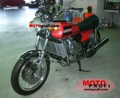

Didn't Norton make a Rotary bike engine??? :shock:
Dicko
PostPosted: Wed Sep 10, 2008 8:39 am
So did Suzuki - the RE5.
