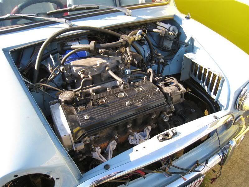

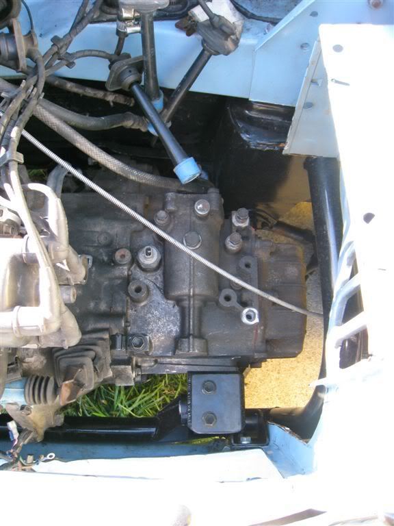

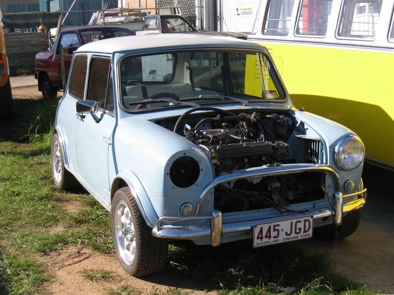

Updated with spy pics:
It hasn't got the exhaust manifold or turbo on it yet so I don't know how he intends to mount that. Similarly, I don't know his plan for cooling.
I can't say I'm a fan of some of the sub frame details but I've never checked it out up close. The engine mounts off the frame tubes are nicely fabricated.
Air conditioned, Nat will love it...
M
PostPosted: Sun Jun 29, 2008 3:39 pm
Doesn't look too bad, anther sleeper is born :lol:

yeah the turbo was on it when we were fitting the power unit into the hole, but it really needed to be moved, so they`re fabbing up a new exhaust manifold for it to fit it in a better place with more room
& Dave (the Custom off Road Fab man) is pretty good, but it`s only his first attempt at a jap engined mini subframe,,, my subframe design & Jig will be finished off by Dave for us shortly too, because my usual metal fab man (Dale) broke his leg recently so Poor old Dave will be breaking his back, munching his knuckles & tearing his hair out finishing off our suzi / toyota/ mazda/ mini frames shortly,,, as soon as i rebuild the gearbox on my kombi (again) i`ve now lunched 3x kombi boxes in 3 months, i`ve just ordered a full set of Albins race gears for it & looking around for a turbo 4x4 porsche gearbox to throw at it later in the year... Peter at Custom is sick of seeing my kombi there :-) I can`t wait to show him the twin turbos i have for it tho :-) i should video the look on his face when i tell him :-)
PostPosted: Sun Jun 29, 2008 4:39 pm
Posts: 39752
I'd like to see what the RH tiebar bracket is attached to, that's the weakest part of all the Starlet subbys I've seen.
It's usually dangling on a bit of RHS tube with no bracing underneath back to what's left of the subby.... :evil: :!:
You are putting 75+HP's worth of forward thrust onto this one bracket... I've seen a RH guard crack because of it.
If I was the certifying engineer, it wouldn't pass. :lol:
PostPosted: Sun Jun 29, 2008 4:48 pm
Yeah Kev, Dave is onto that area, i made a point of it when i was helping him, Altho i havn`t actually seen what he came up with yet.
I`ll be over there again next week & i`ll see what he decided to do.
My frames , however, are a very different design , mine are more like the original mini pressed metal plate, triangulated type approach... very time consuming & obviously more costly , but laterally & torsionally very much better than "ANY" others you will see.
