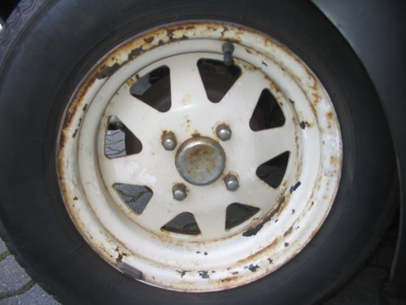

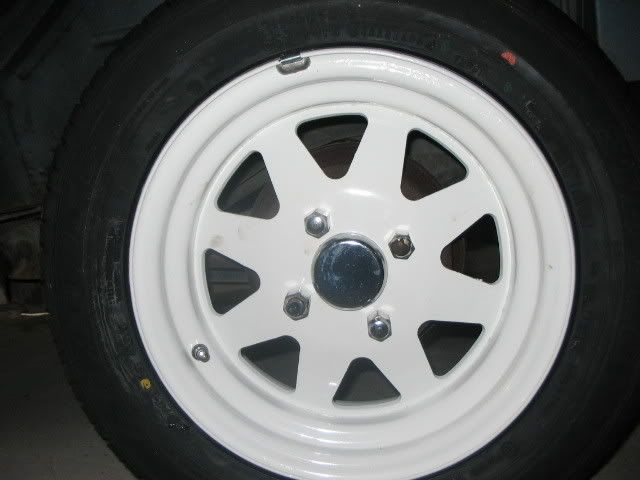

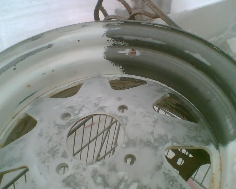

The soda blasting is gentle on the panels, which makes it no good for removing rust. After it's been blasted, you just have to make sure that you clean and neutralise the panel. Simple as a rinse with watered down vinegar and then hose down.
Here are the moke wheels that I recently had done (Before, during, and after).
The soda was that gentle that it left the texta mark on one of the wheels where someone had written "Layland" on it.
