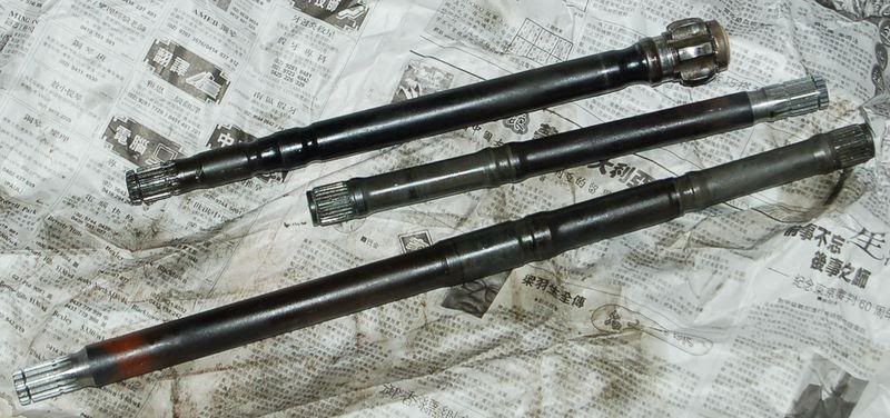

PostPosted: Fri Jun 01, 2007 11:36 pm
Pay him to come measure :lol:
These are my shafts done at the same place:
