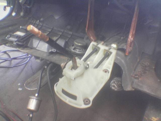

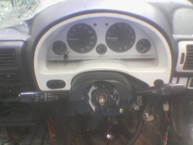

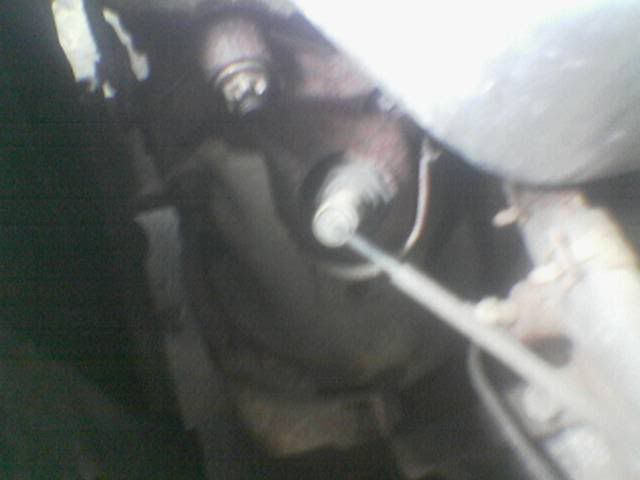

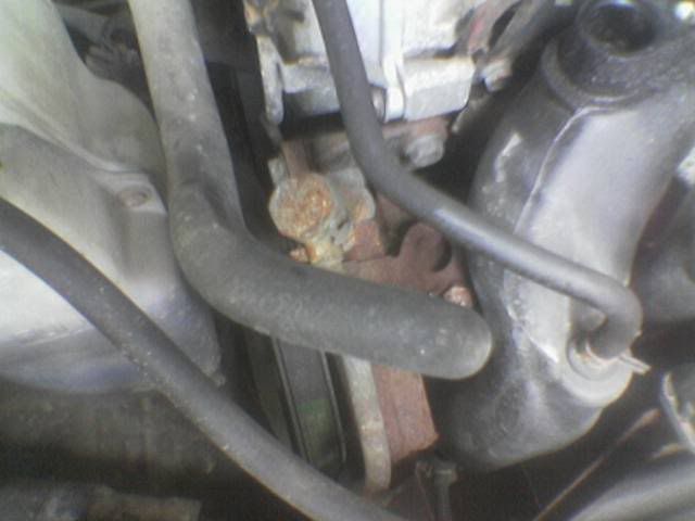

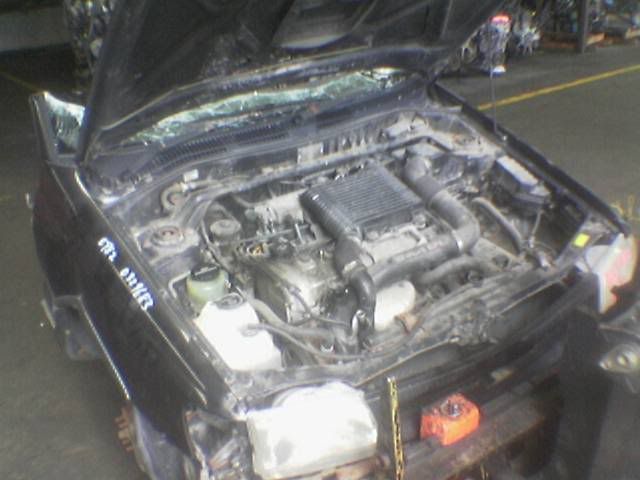

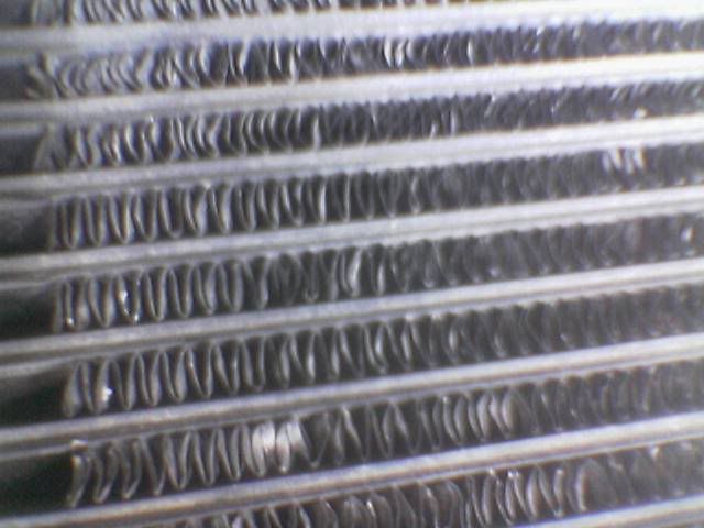

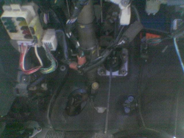

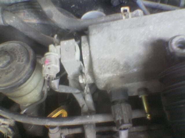

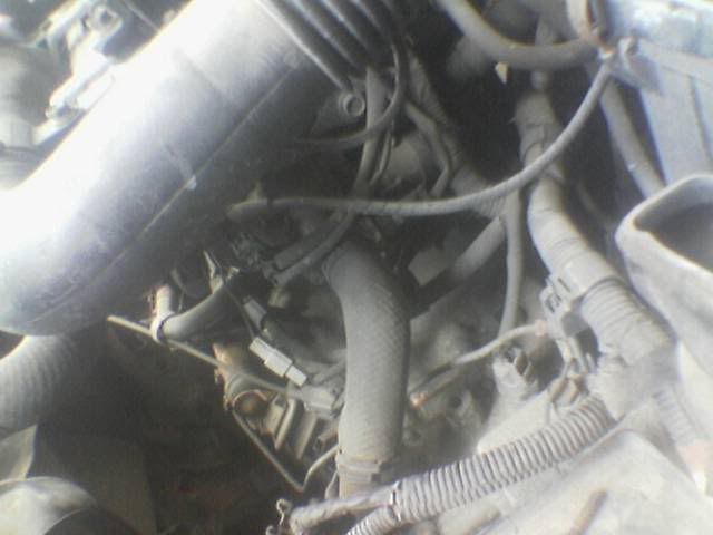

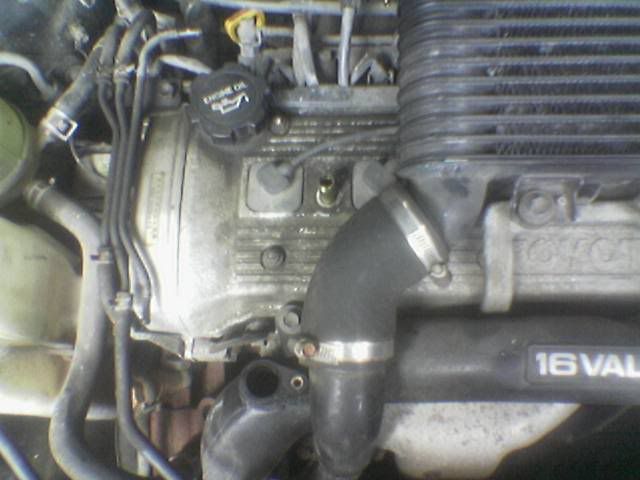

hey guys ive been following this forum for about half a year and finally decided to join...im starting a 4E-FTE conversion with my clubby and ive been looking around for half cuts and found one for $1500 at a jap imports place which is a prety good place..only thing is im not too sure if its in good condition so i got some pics to put up to see what you guys think. The guy started it up and it turned over first time and didnt blow smoke or anything and sounded good. i would love to get this as ive been looking all around for a reasonably priced half cut but i dont want to ruch into buying this one if its not good! andyways ill let the photos do the talking and any feedback would be much appreciated
sorry about the bad quality i had to take them on my mates phone.
PostPosted: Sat Jan 20, 2007 3:10 pm
Posts: 2452
from the pics it looks ok, and if starts and runs nice then thats a bonus.
Looks like a 93-94 model with the analoge boost gauge in the dash, stock airfilter box is good sign its probably pretty stock motor.

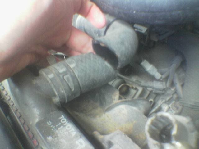

They cut the radiator hose for shipping so no concern there. dosnt look like it has has to big a hit in the front to damage anything which is good.
Bit of rust on the gearstick and radio bracket, id say it was in the weather for a while, but looks like the bonnet is still there so motor should be fine.
Timing belt looks to be done at 100 000kms which is good, how many kms on the dash?
It is missing the stock blow of valve and intercooler plastic cover.
Good way to tell if its been looked after is to take the cam cover off if they will let you. If it looks nice and clean in there then chances are the oil has been changed regulary, if its all sludgy or rusted it could mean its been abused.

I looked at the filter itself and it looked in good condition too so that was good.
i also asked the guy there and he said he hasnt had many people ask him about it in a while which im guessing means its been there for a while hence the rust in uncovered places

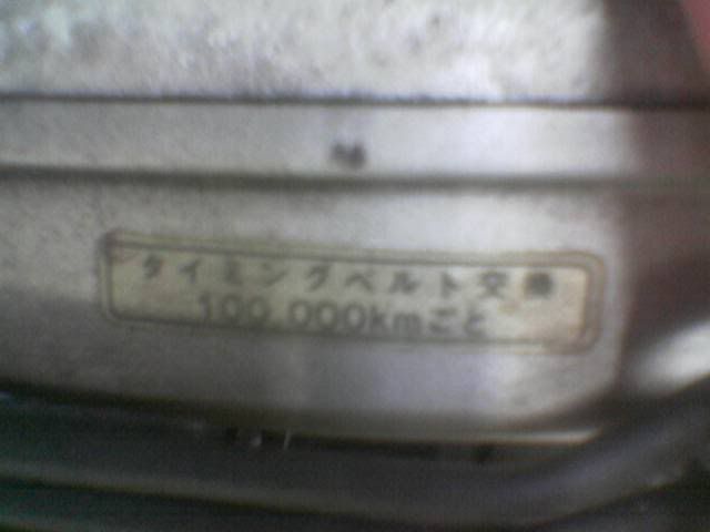

umm there were approx 145,000 km on the dash and i was wondering what the sticker was on it so thats a plus.
i also had planned to sell the intercooler and go for the FMIC so i wasnt too fussed with the missing plastic.
next time i go in there ill see if they'll let me take off the cam cover cause like u said its a good way too tell.

The sticker means the belt HAS to be changed at 100k - whether it has been done or not is another issue - but since the donk will be coming out, it would probably be good practise to change the belt anyhow

oh true thanks. ive read i should change the belt when i get it anyway. i had some girl try translate the sticker and all she could get was the word "belt" :shock:
PostPosted: Sat Jan 20, 2007 10:32 pm
Joined: Fri Apr 21, 2006 6:30 pm
Posts: 98
a literal translation is:
"timing belt change 100,000km respectively"
Successful Trades: Benjamin, minikook, Gordo, 2 S's and a clubman, mattsmadmini, shadow blue, 1018cc, -=MiniMafia=-, hueylui
PostPosted: Sun Jan 21, 2007 12:45 pm
Posts: 2360
Location: SE QLD
NP - the subaru has the same sticker on it - elaborating the belt actually broke on mine between the GC and Toowoomba - stopped me dead to rights - even though the seller said he had changed it. Seller was billed for the damage to repair as it had a 3 month warranty...cost him $900 all up including the tow. Dont skimp on it - it will ruin the motor. Soobs are unique in that the LH belt drives the cams and the Dizzy/oil pump hence no damage. I would hate for you to get it all finished and then blow it all due to a $60 part.
