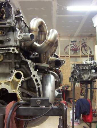

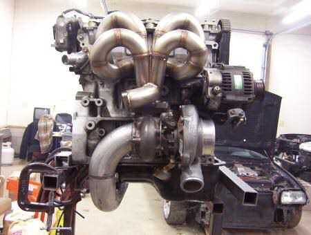

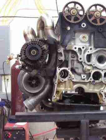

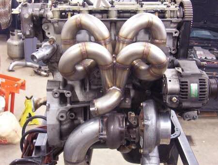

Hi Matt,
I have the same dilemma with the TD04 L.
I have attached some pics of a manifold that I will try to emulate in the Mini.
Notice how slimline it is, I believe it will fit the Mini with just a bit of room to spare.
Should be good for some really hi flows, and getting all the available horses out of the 4EFTE.
Andrew
