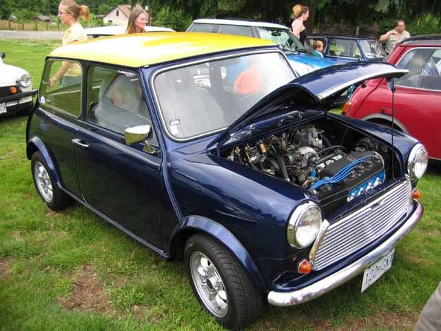

Here is a picture of the Mini I mentioned in my last post. I don't think these flares are too big. This car is a good sleeper.

Thats a nice mini TurboOrangie... The flares arn't too big at all. I doubt it'd be able to fit in right hand drive mini without extensions. Especialy with the radiator in the front..
that one has an extended front....
just pick an engine and stick it in the front of the car, see what you've gotta do to make it fit and start welding - no-one is really qualified to tell you what can and can't be done until they've done it.
the people with big flares on a VTEC are the ones who have used a modified metro subframe as per the kits in the UK, these kits also suit the K series 2l motor. No need to do that as you can see from the car above... that motor is far enough forward to clear a left or right hand drive car
I say a VTEC can fit in a RHD mini without moving the rack or extending the nose, but I'm not qualified to say that cos I haven't done it, but I know it's been done...

I know that Mini does not have an extended front, I know the guy, I've seen the car and part of his goal was not not lengthen the nose. He had a custom intake manifold fabricated so he could fit the VTEC in.
no kidding - must be a trick of the light - I correct standed ;) I didn't link your earlier post with the picture... sorry
well then, I'm even more sure that it can be done in a RHD car, cos the intake manifold is the bit that causes the clearance problems

Thats Mike. Def not an extended front on that one Simon! You can even spy it yourself on his website.....
It may not be extended front but it is left hand drive and being that we are right hand drive it means without extending the front you have to move the master cylinders and also move the steering rack to clear the g/box/diff and driveshafts, not impossible but a lot of work :D

that doesnt look like the 2 litre vtech motor anyway??? correct me if im wrong but to me that looks like a late 80's sohc one?
bugger... I shoulda picked that, nice pickup Meeni - it's a SOHC D series (1600cc variety), and not even a VTEC one... I have one not 5 meters from where I'm sitting right now (1500cc - slightly different rocker cover), the B series motors have a very different rocker cover... spark plugs go inbetween the cams.
The B16 motors are bigger, but I still maintain that they'll fit without stretching or moving stuff - there are 2 in melbourne
but I still don't know the guy - what's his URL?
that motor
vtec version of the same
you don't have to move the master cylinders on an RHD car with a honda motor, because the motor sits on the passenger side of the car, opposite to the swifts, starlets etc. The steering rack problems come from where the gearbox is, and combined with the size of the intake manifold meaning you can't lean the motor back as far as you need to to clear the rack, and clear the manifold - make a new manifold and problem solved.
