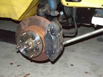

Mokesta, you brought your's on the plane too! I did that the whole kit include two rotors, callipers etc. Went through 6 Xray machines without a problem. Here's a pic of the kit I got with flanges (you'll notice no lugs etc). The flanges maybe specifically designed to get around metro drive flanges.
Matt

Those are Metro drive flanges in the photo you submitted. You can tell by the large outside diameter. The four raised lugs are between the wheel nut holes and the big centre hole. The lugs on mine were machined off by Mini Spares as part of the kit. I have had the outside diamter reduced to match the standard mini diameter to suit the Moke Sunraysia wheels, which dish in and clash with the large OD.
It is not only the diameter of the calliper securing bolts (metric on Metro) that makes the solid disc drive flanges unsuitable. It is the distance between the swivel hub/upright and the insaide face of the drive flange. If you try to use the solid disc drive flange the disc face will strike the hub where the steering knuckle attaches AND the inside face of the disc hat (where the mount bolts are threaded) will strike the hub where the wheel bearing seals are. Only machining the disc where the threaded holes are will allow use of the solid disc drive flanges. The disc may then not run in the centre of the calliper and spacers could be required.
The photo below shows the set-up. I have spaced the disc and callipers towards the car by 3 mm to clear curved sunraysia wheels. It is not possible to space them by 5 mm. The standard drive flange has the inside face about 8 mm closer to the hub than the metro (it is not the same width). So, about 5 mm of the 17 mm thickness of the top of the disc would need to be machined off the disc AND the drive flange holes would need to be opened up. The combination would then work and you would have the correct track. You just couldn't swap discs quickly.

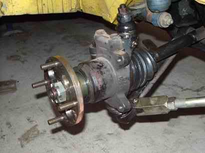

Yeah Mokesta that was a bad picture. I'll show you the other ones. Also here's a pic of the braided lines etc...
And here's the brakes from another angle. They came like this and had not been machined.
My setup seems to run fine, wish I had a pic from the same angle so we could compare. May take one tonight because mine are a lot thicker than yours (flanges).
Matt[/url]

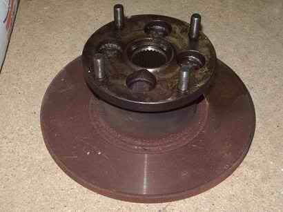

OK the drive flanges in your photos are Metro. The groove around the middle nut is the give away. Check out the standard Mini 8.4" solid disc flange below:
See how the standard flanges have the rasied portion around the nut and how the nut sticks out 12 mm further, indicating that the wheel mounting face is 12mm closer to the car.
This is the Metro flange. See the groove and how the nut is further in:
So, what you have is machined Metro drive flanges or ERA turbo drive flanges maybe... Either way the vented brakes do not fit onto the mini hubs with standard 8.4" solid disc drive flanges.

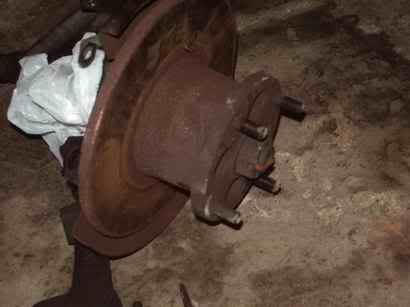

Here is a Metro flange on the hub with no disc:
