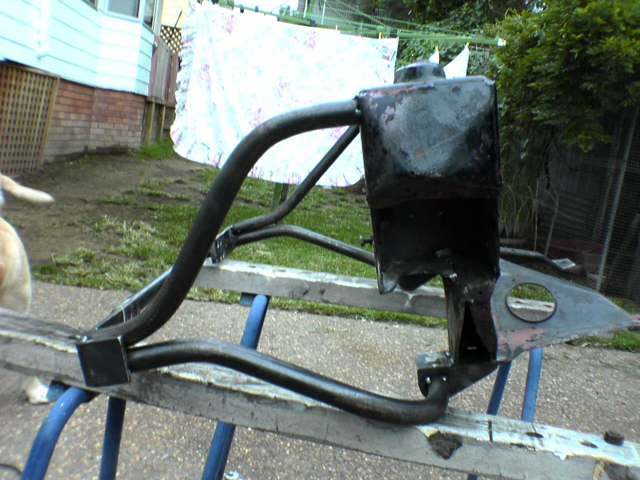

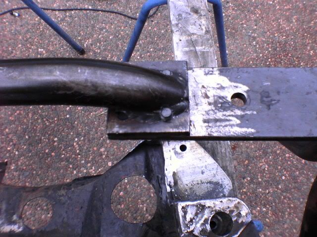

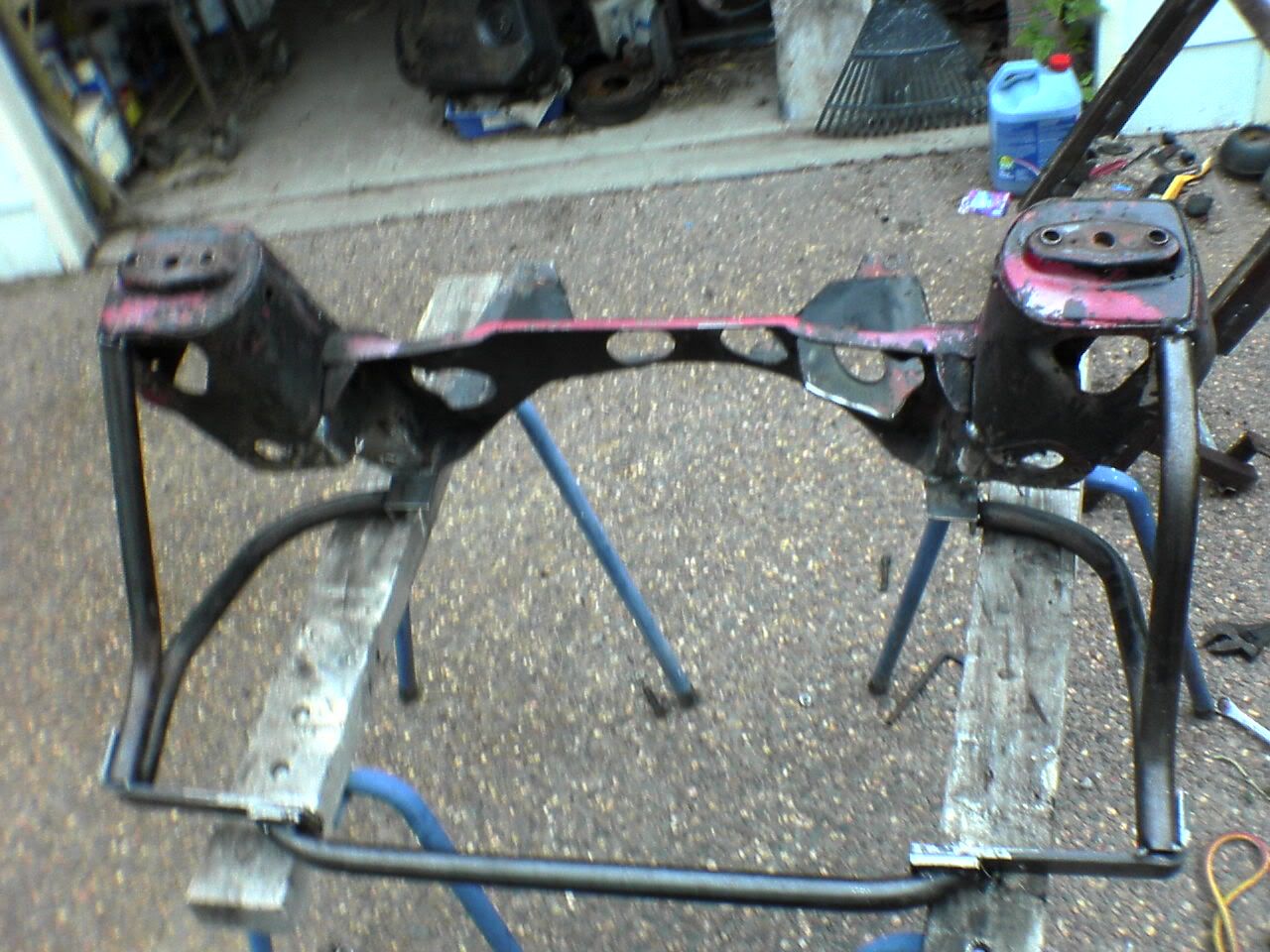

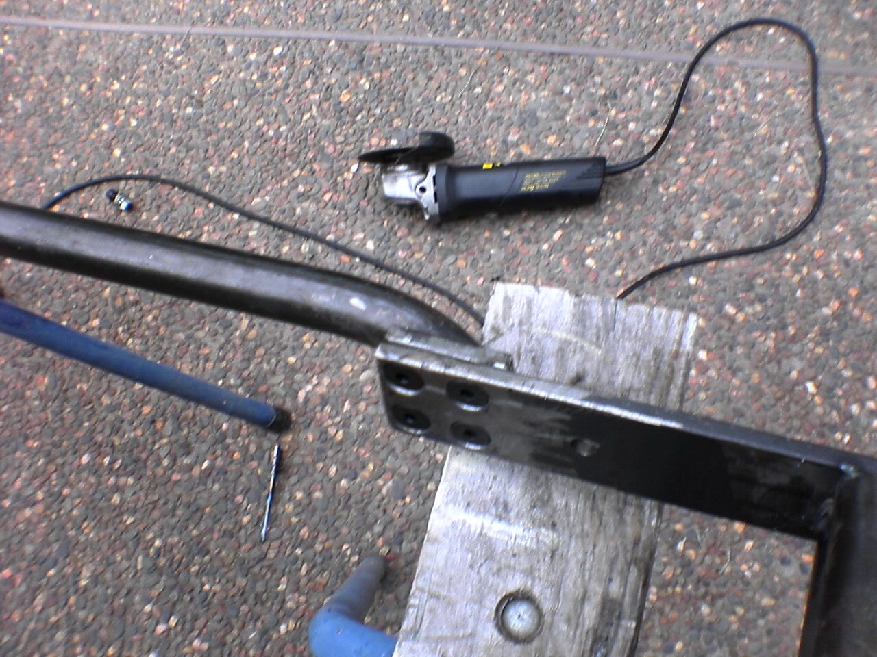

well its basically the same as most of the others that you have seen, except the bar at the front. I chose to bend mine and use 8 c/sunk 12.9 M8 hex screws.
Still need to make the mounts up. more clearance needed for the rear of the g/box too.
but it is progress.....

oooOOO purdy...looks alot like JC's :P
no offense or anything but...is it just me or does it look a wee bit on the flimsy side? the one i've got planned sure is ALOT beefier than that...perhaps unnecessarily so :?

just you I guess.... engineer thinks its ok....
PostPosted: Sun Mar 05, 2006 1:50 pm
Looks like a neat piece of work 8)
I agree that a lot of the others are WAY over engineered!
(I include my own in that category)

Looks great , tidy work ....well done.
Is my subframe the only one with a removable centre crossmember? i notice the 4fte's dont use one either?

Looks good, Inazuma be careful not to overdesign and end up having unnecessary weight.

my front bar is removable, makes it easier to install im my case... (c/sunk screws) lucky that the oil filter is not that hard to remove either.... I don't need to remove the bar to remove the filter.

what size members did you use dan? i am looking at 50mm x 50mm RHS with 5mm walls...spose i could ask the engineer...

Ina, you;ve got to remember how cramped for room it is in there aswell. When I read you "50 * 50" comment i got my ruler out and said to myself ">>ck that's huge".
Anyway, good work Mano, Ron will be pleased to see his brainchild populating allover the country.

40x40 was my other option :) just thought that it might not be enuff...
spose 50x50 is a bit on the massive side...

Don't go over the top with 5.0mm Wall Thickness
A little bit of gusseting in the corners would be a lot more effective :idea:

well i was gonna gusset pretty much every corner that formed a 90 degree...which is a fair few...i havent discussed any of this with the engineer as yet...i wanna make the jig first...then i will have a better idea of what i am gonna be doing...all i have at this stage is a few rough sketches and a mental image of how i want the finished product to look...
