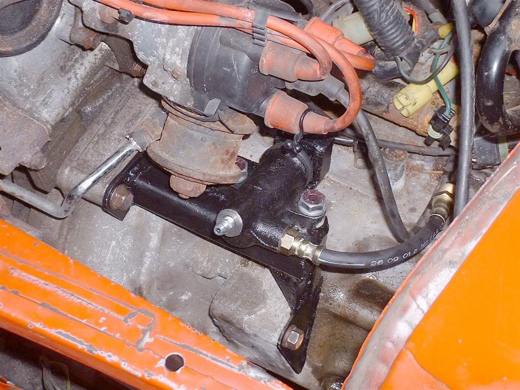

or it might be easier to mount a slave cylinder on the gearbox and keep it hydraulic?
HOw much does the mini slave cylinder move from engaged to disengaged , i might be able to use the standard mini slave cylinder???
Whats the pro's and con's ?

Oh, bonus is no more PITA hydraulic master & slave cylinders.

my engine uses hydro clutch so i dont know to much about the cable setups, but most the suzuki gti guys convert there cable to hydro using the mini slave cylinder with custom mounts.

I haven't seen where it might be possible to mount a slave cylinder on this set up. But after thinking about doing a cable set up and seeing the pics here I would definately try my best to go hydro. I have a Suzuki engine/gearbox in my Mini and it took me about 2 hours to convert mine from cable to hydro and have the bugs worked out. I used the Mini slave and a custom bracket.

I had a look at going hydro but the slave cylinder was really to low in the front, as it turned out it was pretty straight foward.
