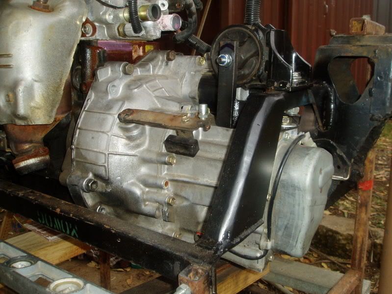

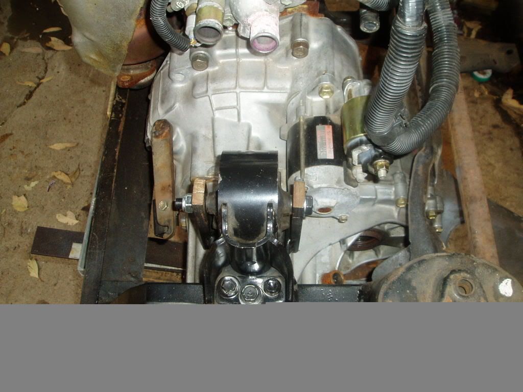

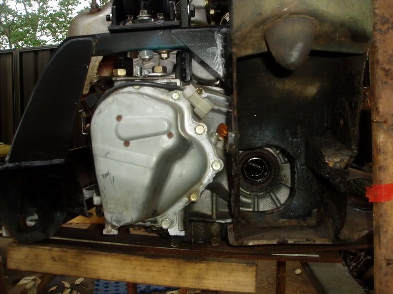

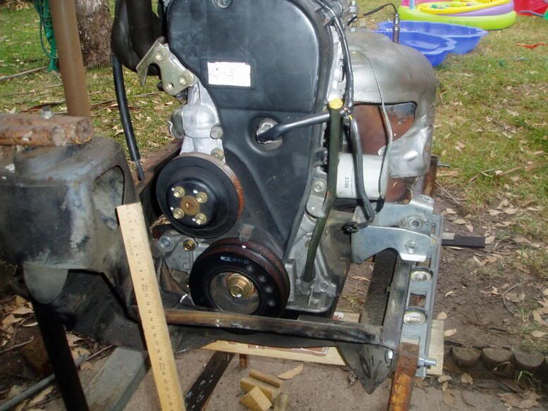

Here is pics of my conversion we put the motor in the first time today. There is way more room on this compared to the 4efe i did last year(03). Next is the front and rear engine mounts and front mounting the alternator.
it wont scream like a starlet but this motor is 50kgs lighter than the 998 but is the same capacity, has twin cams and injection + 5speed and is something different
8)

PostPosted: Mon Jan 02, 2006 8:32 pm
Posts: 11847
i like the stenciled mowog on the frame :)

couldnt of done it without the awsome jig :wink: :wink:

Brilliant Job there and should be a great engine. I'm amazed by how compact it is...Well done. Nice frame too...

Is there a reason you didn't go with the 1.3?
PostPosted: Tue Jan 03, 2006 9:42 am
Posts: 461
Location: warrimoo nsw
a Mate of mine at a wrecker owed me a favour so this motor and box + all running bits cost me nothing :D :D :D
and the smaller capacity motor so far has been easy to fit

Impressive. Looks like there is limited amount of subframe work required for this conversion compared to other conversions.
Keep up the great work.
