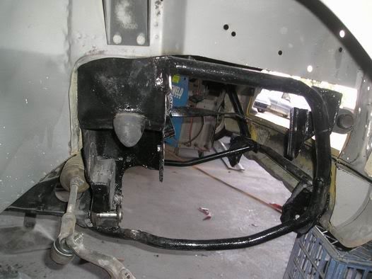

Hey guys and gals i had an engineer come out to take a look at my mini the other day and i found out a bit of
info on what can be done and what cant be...
Im going down the Turbo Suzuki GTI path into a 68 round nose van.
Ok so first with the subframe...
Where the bottom of the tower is (where there is no braceing now) he would like to see some braceing
made from the bottom of the tower to the top rail, i was going to do it anyways, it does look a little weak.
And an aftermarket ECU is "illegal" they are a straight up defect if they are fitted, but as if you would
keep the stock ECU, so im choosing to disragard that bit...
The wheel track can only be modded by up to 25mm, which is 12.5mm either side..
Also needs a colapsable steering column, and obviously being a 94 model GTI motor it needs to comply
with that years pollution issues, and the exhaust db needs to be 90 db or less...
There was a couple of other little details if anyone needs to know anythin else i might be able to help
