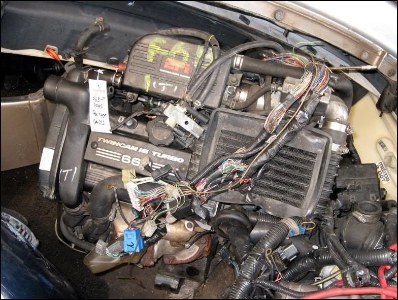

This is a pic of the one im planning on next year into an 850

PostPosted: Sun Oct 08, 2006 8:44 am
Posts: 2292
that is the best little performer I've seen in a while ... I'd love to gvet more stats and pic though.. anyone? I tried google but nothing much came up. Can anyone show me where to find the stats or more pics?

the f6a is running in a mighty boy a friend of mine has and their engine bay would be smaller than a roundies (just on looks)
