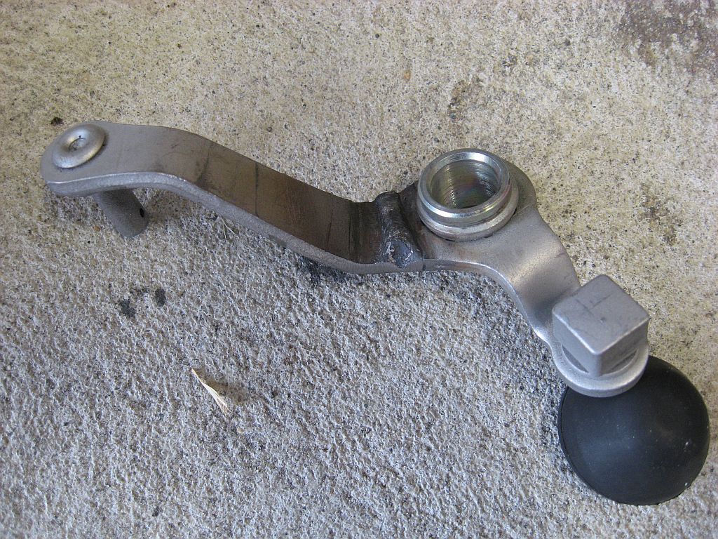

Then the gear selector linkages were modified. There is only one lever that needs modifying - the lever that moves the selector in/out of the gearbox when you move the (in-cabin) gear shifter left/right.
The lever is disassembled, cut and rewelded upside-down
Before the arm is rewelded though, it is important to ensure that there is about 25mm clearance of movement back & forth and that the clevis pin is high enough above the gearbox to be able to fit the cable back on. The new configuration is then mounted on the opposite side of the factory position (but still retains the correct direction of movement of course)
