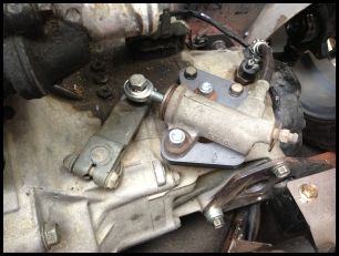

Why can't you use the standard cable clutch? I'm sure you all have the answers, I only posted that link to show that the conversion to hydro isn't difficult and has been done with parts endemic to the model range. The image of the cable clutch adapted to a mini uses a standard cable, and probably pedal box, and although I haven't attempted this conversion (mainly because I have a swift and like the engine where it is) I can't see why it would be difficult.
PostPosted: Tue Apr 09, 2013 10:48 pm
I drove the swift before I dismantled it and the clutch felt like a soggy sponge. Not good - I only looked at it as an option to get me by till I go hydraulic later on.
It sounds easy, but its not. The cable isn't long enough to go into the car, and its too long to go to go to where the pedal is. It gets there, but it fouls on my subframe. To get it to work I'd have to angle it out and I'd prefer the space for my inlet manifold.
The hydraulic setup now looks much easier. I shorten the suzi arm, and make a new bracket to mount the slave on the gearbox as has been done 100 times.
Strange as it sounds - its a more compact setup too, something I need now that I've test fitted the radiator, which was hitting the cable mount bracket.

Thanks for all the input on the clutch arrangement, I've got some more bits on order at the moment that should have the mini slave cylinder doing the job for me easy enough.

Back on my car though, I have now got the bits for a hydraulic clutch sorted:

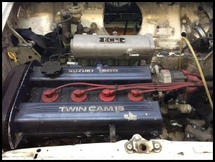

And I've got the intake manifold sorted:
I had the engineer here this morning for a look-see.
No problems I need to address, so I can go hell for leather and finish it all.
