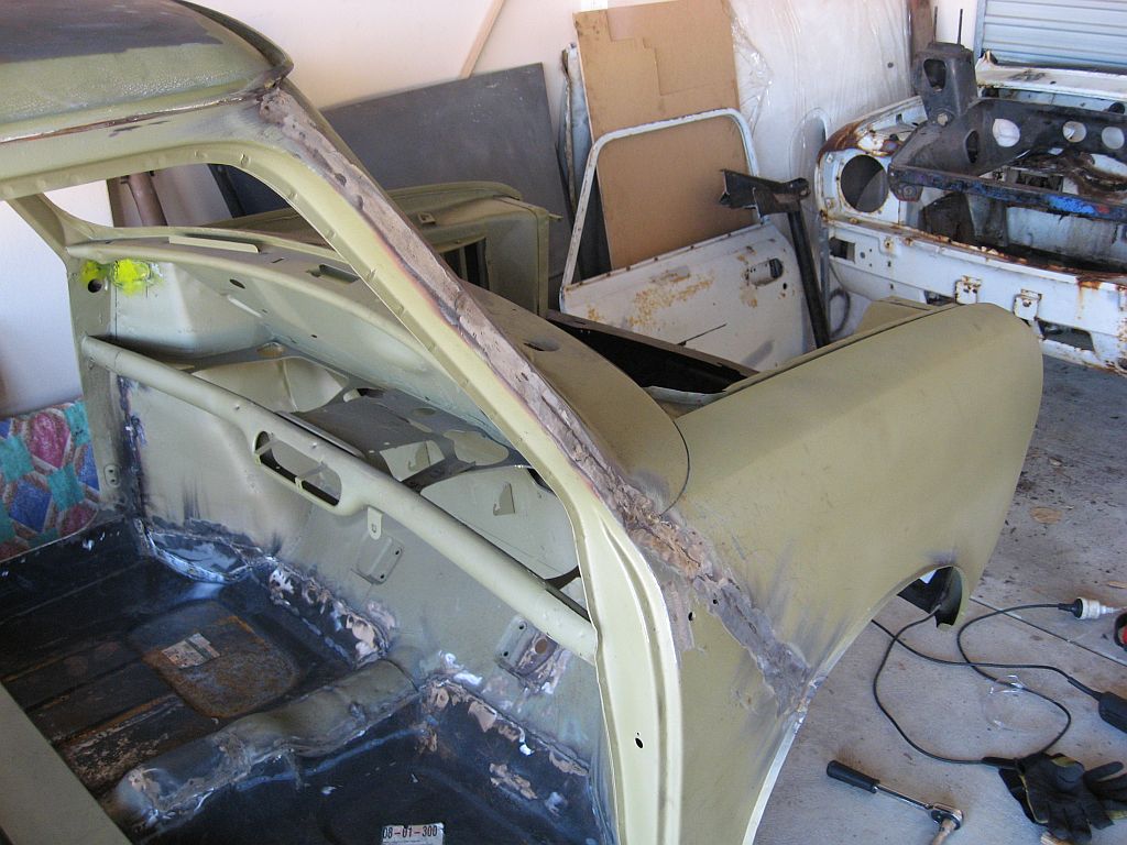

My shell has been away getting rust repairs and deseaming done for a while and after many delays, I picked it up on the weekend. It had been gone for a day short of 6 months :shock: I didn't really want to start building the front subframe until I had the shell back, because a new front valance had to be fitted and you can never be 100% certain that location of the old subframe mount holes will be exactly the same as the new valance.
I'm currently juggling attending (too many) weddings, bucks day/nights, birthdays and dinners with seemingly minimal Mini-time, but I hope to make some good progress on the subframe and (fingers crossed) finish it in the coming couple of weeks.
Until then, here are some pics of the shell. New panels fitted were front valance, rear bumper section, both sills and both footwells. Small rust repairs were numerous. A & C pillars and rear bumper have been deseamed. Unfortuantely, at closer inspection, I'm not really happy with the average quality of the welds (gasless MIG was used), finishing and rust repairs so if you want to know who not to take your shell to, just PM me.

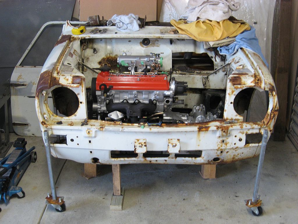

I don't normally post minor parts of the build here, but I thought this may be handy for others while trying to position the engine in the correct spot.
It's been mentioned in a few other builds that the engine needs to be tilted forward a bit to stop the intake manifold from fouling against the bulkhead, and after some lateral thinking of how to get the engine correctly positioned without the use of a heap of jacks or stands, I came up with this. I measured how high I wanted the CV cups and drilled a hole at that height in a 100mm square block of pine so that a long bolt passes through the block and into another piece of wood that was cut (like the shape of a tri-bearing) and put into the CV cup.
I was then able to drop the crane height and the engine rotated around the axis of the driveshaft and so easily tilted forward.
A little bit of tweaking the position back & forth and I now have the engine in it's final position so I can fabricate the engine mounts.

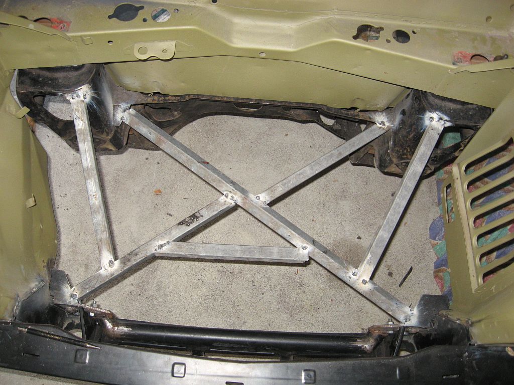

The front brace bar (this is before the valance was fitted to the shell) was fabricated.
As usual, the front of original subframe was cut away and a frame was tacked together to enforce the subframe position.
Spars (using 32mm OD tube w/ 3mm wall thickness) have been bent up and welded in place, ensuring that the drivers' side spar did not foul against any pulleys or future belts.

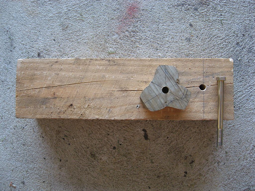

Now here is the major difference in my subframe compared to those done so far. I am using rubber "cotton-reel" type mounts from a V8 Land Rover for the front & side mounts. They are much more compact than the Starlet mounts and given they are designed for a V8, they will be more than strong enough for this engine. I put the idea of using these mounts past my engineer and he saw no problem with it.
This was my first attempt - mounted at a 45 degree angles, but then after talking to a local Land Rover workshop, I relalised the correct angle used in the V8's is 30 degrees, but I don't have a pic of the correct one.

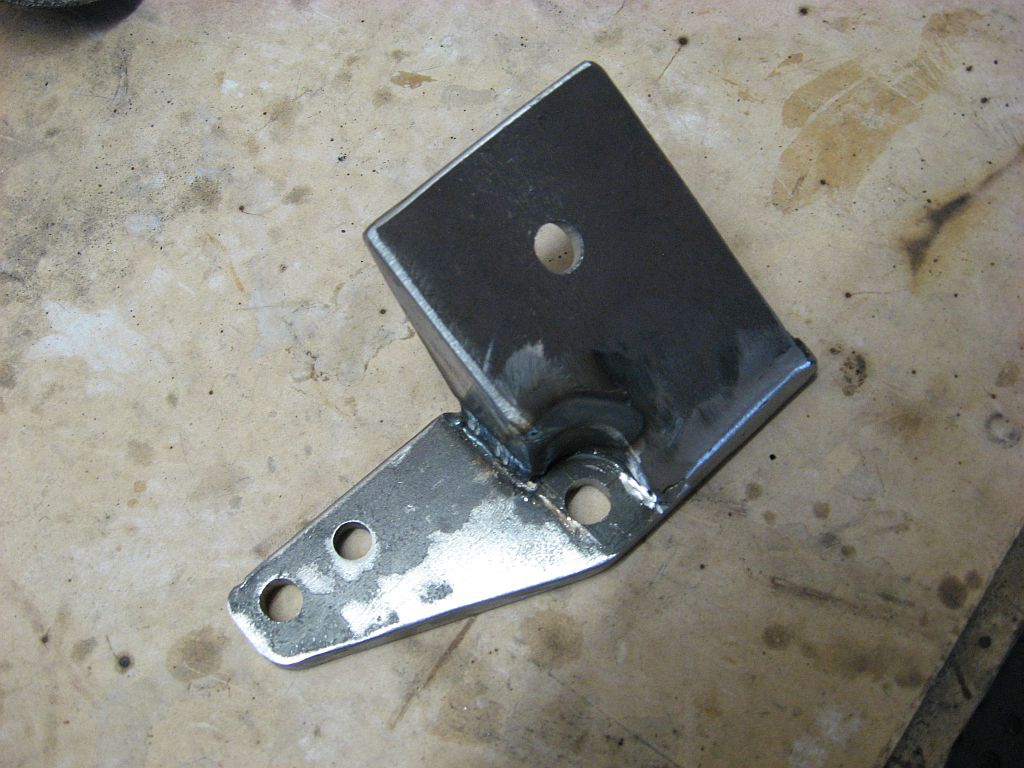

The side mount was was made from some shaped steel plate (all plate used was 6mm) contoured around the spars.
The side engine mount bracket ended up looking like this. Due to the position of one of the bolts, I had to cut away the corner of the angled plate and weld in section of tube so that the bolt could still be used.

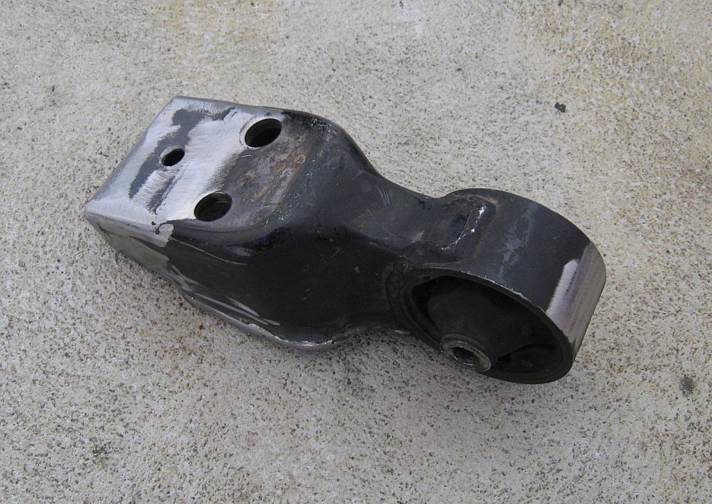

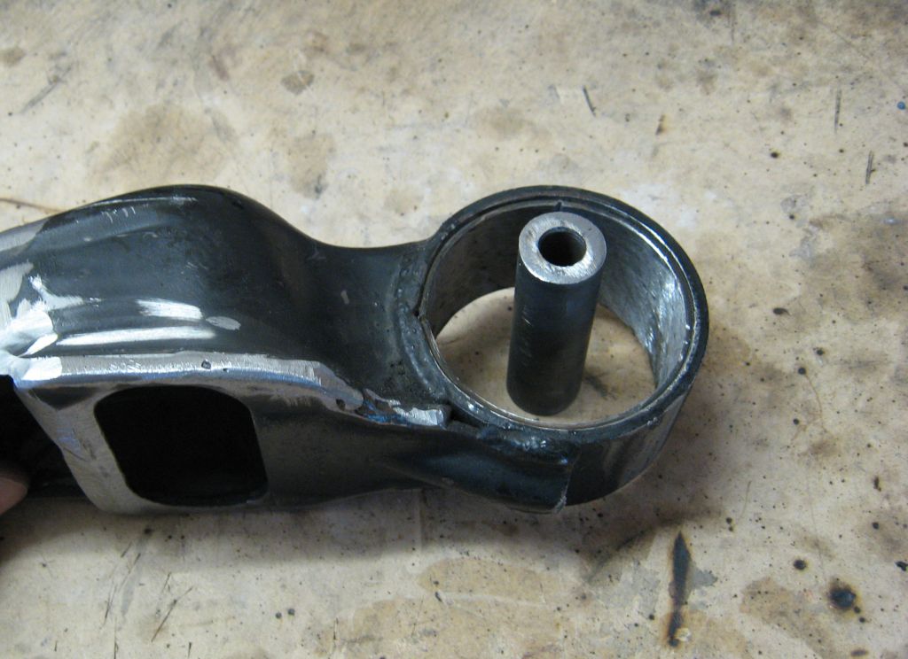

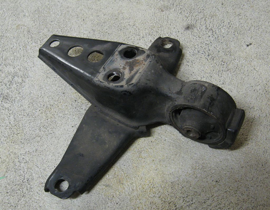

Using a Land Rover V8 mount for the rear engine mount was going to make fitting the engine a bit tricky due to the bolts cast in the rubber mount all pointing inward, so I decided to use the Starlet mount and have the rubber (which was cracked and perished anyway) recast in Polyurethane.
I trimmed down the stock mount.
cut off the "wings", added some 3mm plate and made a type of box section as well as adding a third bolt hole.
The rubber was badly cracked in the mount so using a chisel and dremel, it was all cut out
The new polyurethane cast - in Shore 65 hardeness. This is still quite hard for the mount so as per suggesstion of the casting company, I drilled a series of 8mm holes to provide some further flexibility
So to figure out where to bolt this, some 5mm plate was cut to fit between the wings for the mount to bolt to (only tack welded for now)
The mount was clamped into the final position, which gave enough clearance to the to the engine bracket (you can see the single piece of plate bolted to the rear of the gearbox in this pic). The remainder of the bracket was measured and built around the position of the clamped mount
The final design
I marked, drilled some holes, welded some M12 nuts in place and that's that. The engine can now sit freestanding :D :D
