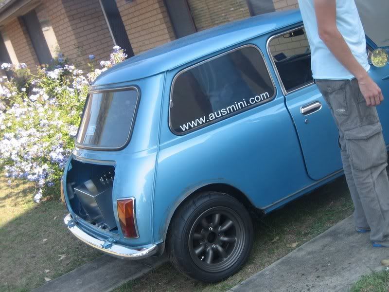

ah jish - did ya getta whole shot of the van with your wheels?
its looked nice from what i can see :lol:
is that acceptable clearance for the arches?
nah mate..only put one wheel on..so no point really.
Yea, i will have neg camber all round so should tuck in nicely :)

Did you try those wheel and tyre combo at full lock with those arches???
That is where the problem lies.

yes we tried it on full lock, and yes the body work will need to be modified as is the case with most 13's. The arches will bend a bit so he should be able to reshape them.

My only concern is the fuel cell in the boot with the battery, and no `deck filler'.
Even if no fuel is spilled whilst filling it, that boot space will fill with the fumes being displaced from the tank. And, like all Minis made, the boot area is not sealed off from the cabin... there are gaps both sides of the rear seat.:?
One spark from anywhere, and Kaboom.
I'd be putting a flush filler (bike tank one or whatever) in original spot, and piping it into the fuel cell/tank. 8)

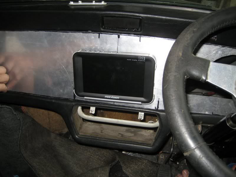

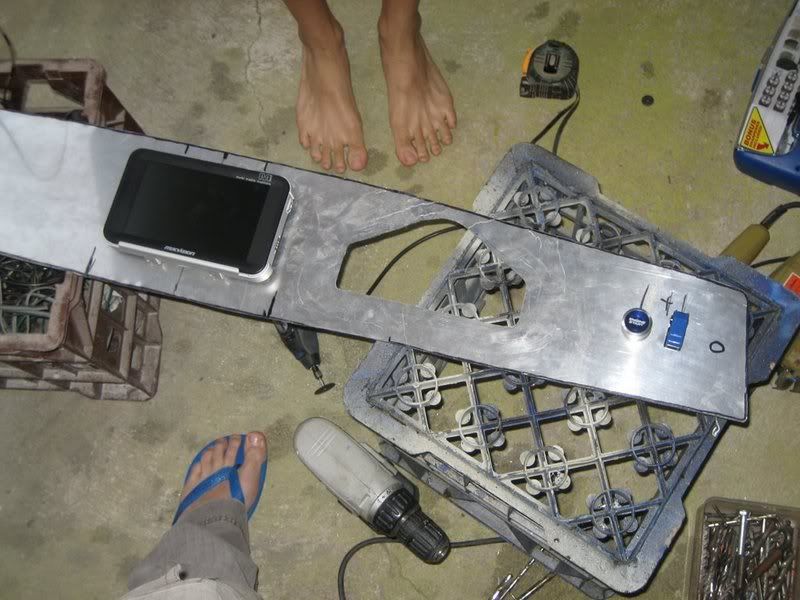

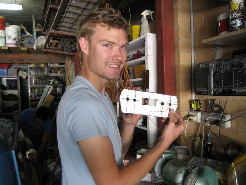

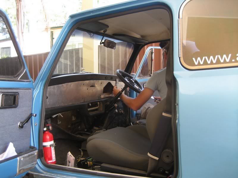

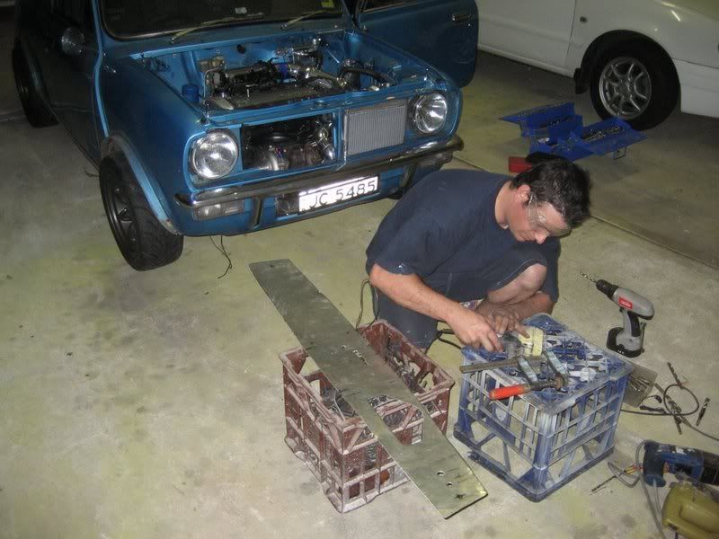

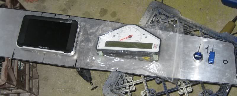

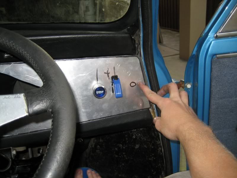

We've all spent alot of time on the dash and i'm happy with how it's turned out so far, it's made from 3.5mm sheet Aluminium and shaped to the dash, using M10 allen head bolts to secure it to some brackets behind the dash.
At the moment it is off getting covered in carbon fiber 8) will be done in a week or two..
Took the flares off..
Brad and Em pulling the old steering column apart, thanks to Aaron for helping me find a column :)

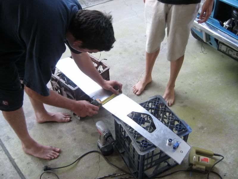

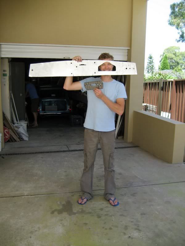

This is the start of the dash making...well a bit into it at least..

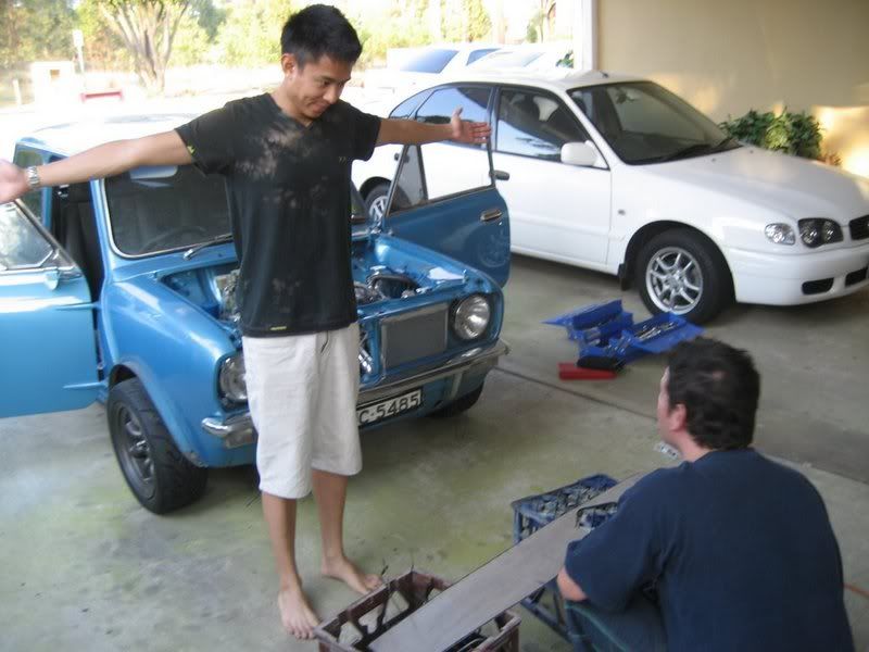

Here is duk using his engineering skills for measuring..
Here is Brad actually measuring..
Me doing some cutting
7" Display/Recorder
IGN/Start Button..
Safety boots on...
Working well into the night...
Dummy fit..
Driving..broom broom...oh wait..
It's not moving under it's own power...yet...hehe thanks for the push Bez..
Switch Panel
You get the idea..
