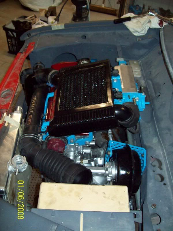

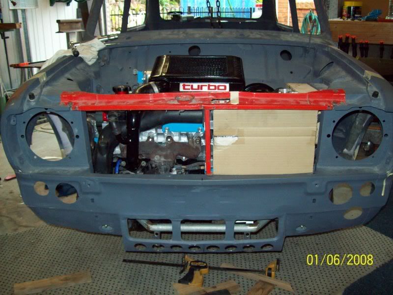

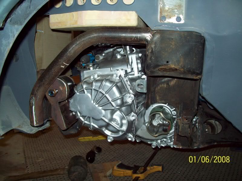

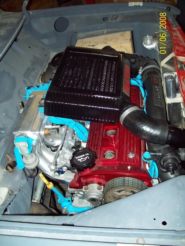

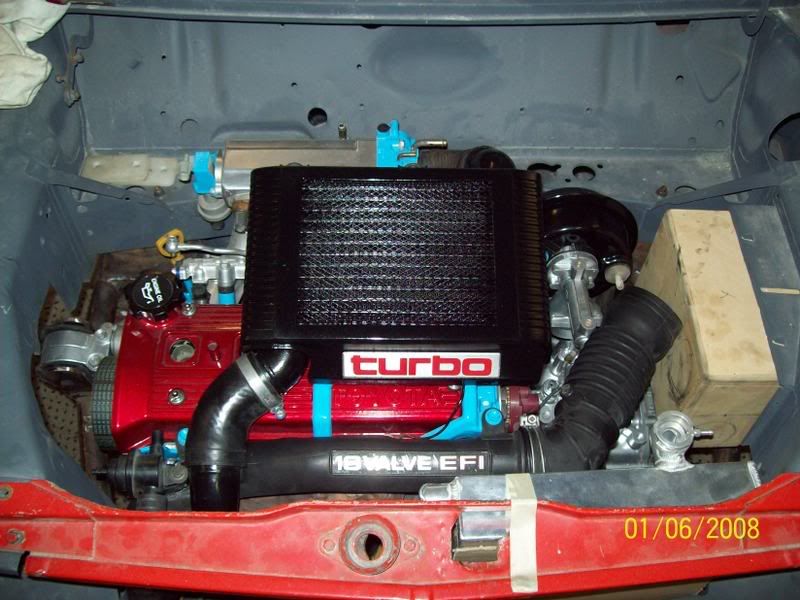

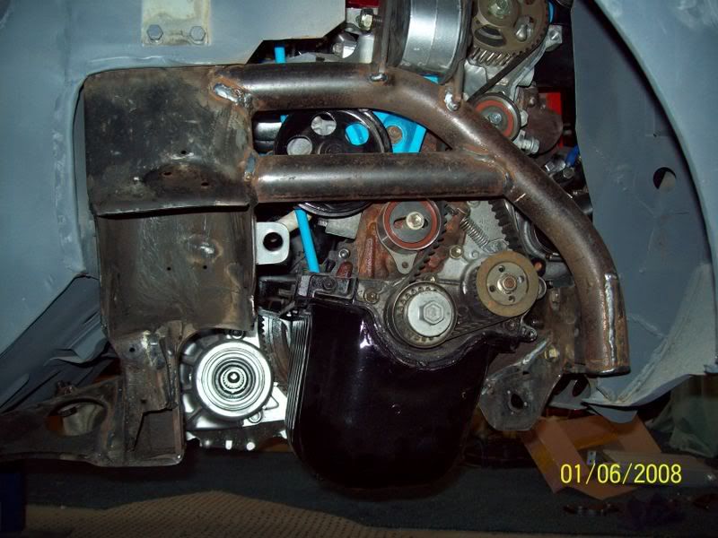

Anyway, quick update. Havent been idle.........
I was ready to start doing the subframe for Sam (front engined 4G92 Mitsu into the Morris), until the powers that be intervened and Sam changed his mind to doing a mid mount RWD. So, I have been busy spending a few hours designing the rear subframe/engine cradle/ROPS for the Morris - it should be good!
Have spent some time on The Cat though - almost ready to send the subframe (New MkIII) of to the powdercoaters and the shell off to the panel beaters :roll: (pray for me!)
Subrame finished:
Engine installed:
You can see the lower link bar easily in this pic which support the FMIC:
Had to alter the brake and clutch pedals to make sure they clear the Starlet steering column (used this because it was collapsible):
More stuff to do, but ulitmately nearly there.
