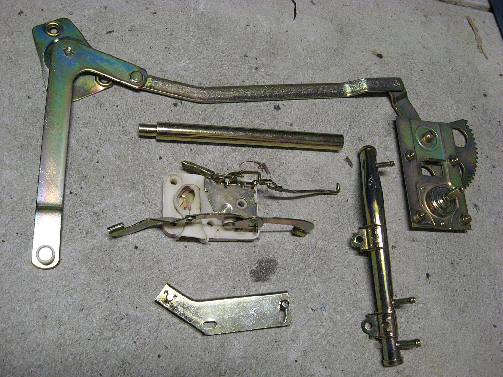

I picked up all my bits after getting it all gold passivated. Awesome turn around time of less than two days. Total Cost $110 - one run for the fasteners and one run for the brackets and larger stuff (which needs to be hung/wired up through the process)
I reckon this process is a MUST for anyone doing a restoration on any car as it restores the original corrosion protection for a very small cost. And you can even put most plastic pieces through the process (such as the door locks) with no damage to the plastic (see "after" pic below).
Before :
After :

Wow they came up a treat!! Could you possibly post up the details of where to get that done?
68 Mini
70 Moke
PostPosted: Thu Jul 01, 2010 10:34 am
Posts: 953
Location: NOR, Perth, W.A.
No problems. I used Zinc Coaters in Welshpool (for everyone else, that's in Perth). http://www.zinccoaters.com.au. They do Zinc plating, chrome, nickel and anodising (I had my aluminium Hi-Lo "cones" black anodised also).
The items to be passivated really do have to be well clean of all rust, grease and paint to get a good job. I have a few clamps which I threw in the batch which I didn't realise were painted - and they look pretty patchy afterward.
-Alan
