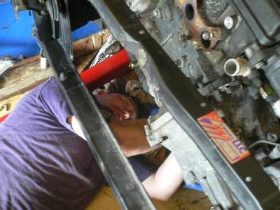

Ta-Da!
8)
A bit of goo here...
and a bolt there..
and it's out..bob's your uncle :)
Thanks Dean for helping us out and Zoe too for putting up with us and for the team management skills 8)
Once we finally got the crane (thanks simon) it wasn't long before we had it out..little bit of stuffing around..how thick are those pot joint boots! geez no wonder toyota's don't leak..gotta love that goo inside :lol:
Pretty happy though, now onto the frame! 8)

Good good. Did Dean draw the short straw and have to get under it?

Considering Dean forgot the crane last two weekends, he got put under the car :lol: ...that and i'm injured :)
Upgrading to a TD04..
Motor was on it's way to brads, who lives near MRC so i can get a new clutch put in and a few other bits while it get a quick look over..
