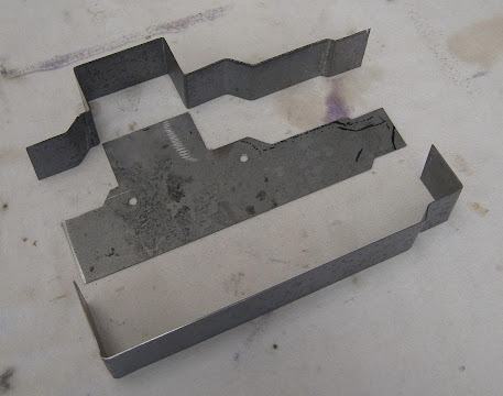

I decided to add to my To-Do list the feature of power door locks / central locking to the Mini and purchased a master and a slave actuator from my Jaycar. The actuators aren't large, but it was going to be a challenge to fit them in the Mini doors and keep them easily accessible in case they need to be replaced. I made an enclosure to house the actuator, made from a single backing plate and some hand bent pieces to create the sides, which were then welded together and then welded into the inner door skin just below the interior door handle.
Note the larger hole to maintain access to the door hinge nut!
The enclosure has two captive M4 nuts for mounting the actuator
The generic rod that was supplied with the actuators (gold coloured rod in photo below) had a lot of free play within the green clip on the end of the actuator, so I made a replacement rod with a small collar that fits the actuator snugly and will use a nylon lock nut to secure it.
The main issue I faced was that the motion stroke of the actuators is 16mm, but the factory Mini door lock rod only requires approx 8mm to lock/unlock the door. This difference was solved by using a rocker arm with a 16mm movement on one side of the pivot and 8mm on the other side. I machined a standoff for this arm and welded it to the door skin, and also had to create a small recess in the inner door skin for clearance of the rocker arm.
After bending some rods for the mechanism, this was the final layout which easily fits under the custom fibreglass door card.

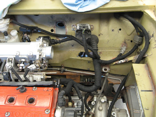

A little mote work on wiring... some bigger gauge wiring for grounds - body to intake manifold, and another large gauge (4AWG) cable from body to the engine block (for the starter motor).
A last minute addition was a 8-wire Deutsch (waterproof) connector at the front of the engine bay which will allow me to disconnect all the front lights and indicators from the main loom in a single step. In the case that I need to remove the engine, I will not have to also disconnect the wiring to all the lights/indicators also.
Now that I have all the wiring routes 100% confirmed for the entire car, I made some cable tie mounts to hold the looms around the car. I cut some 30x10mm pieces of 1mm steel and rigged up a quick press jig for my vice. When the vice is closed, it forms a specific shape for the small piece
These mounts will be welded in specific locations and used to cable tie the looms in place
I also made some taller mounts for the cabin/interior. These were welded to the cabin floorpan and will sit slightly proud of the ~14mm of sound deadener, underlay & carpet that I will be installing.

It's taken a significant amount of time to retrofit all of the Toyota Starlet wiring loom and add any new wiring to the Mini, but it was time to test it all by making my way through my wiring diagram/document and checking off all items - one wire and one fuse at a time. Nothing interesting in terms of photos here, but it took over 20 hours to check everything (continuity) against my wiring diagram and fortunately found no issues in the looms.
Once 12V was attached I went through the same process, now checking 12V available to everything that needed it - and only found a couple of dead globes in the instrument cluster.
With oil in the engine, no ECU/ignition connected I test cranked the engine, only to find the starter motor wasn't working but fortunately this was a simple case of loose connection at the starter motor and then after another test... it worked! What a milestone to be able to crank the engine for the first time in over 10 years! Next step - connect fuel and ignition system for a test proper.
