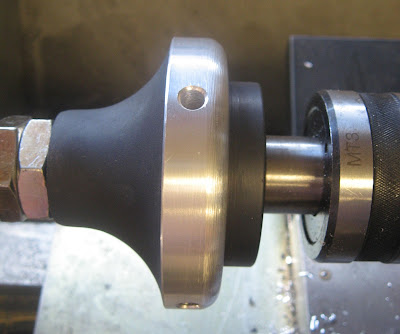

There was an interesting discussion on a Mini Facebook group recently in regards to some of the adjustable Hi-Lo trumpets being sold for the classic Mini and their suitability for rubber cones. The commonly sold alloy Hi-Lo's are designed with coil springs in mind and not the rubber cones. Compared to the factory trumpets with a rolled edge, these alloy Hi-Los are a slightly larger diameter and have a flat mating face (no radius machined) for seating the coil springs.
I'd already purchased a set of Hi-Los a few years ago so I decided to modify them to match the factory trumpets. Firstly, I drilled a series of holes around the outer edge of the Hi-Los so I can insert a rod and stop it from rotating when adusting the nut (whilst all fitted in the car). Note that I've previously had the Hi-Los anodised in a black colour
I then machined down the diameter from approx 88mm to 82mm (same as the factory trumpet)
Then I formed the radius to be close to the factory trumpet.
With the diameter reduced and radius machined into the Hi-Los, the spring rate will be closer to a factory set up
Before :
After :

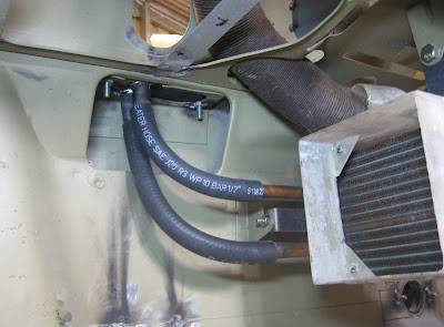

In my previous Mini Clubman, I often had an issue with lack of space and how bulky the heater box was and how easy it was to kick and damage the heater duct near my feet. So I decided to add to my work by making a full custom heater box and boy did it take some time to prototype and finish it! Made from fibreglass, it re-uses the factory Mini heater core but instead of the bulky squirrel cage fan, I've used a high flow 150mm PC case fan - The fan I chose flows a hefty 138CFM at 12V and with a noise level of 48dB, it's not intrusively loud.
With some foam glued around the perimeter of the core, the factory Mini heater core was used and fits snugly into the box.
There is no longer room in the engine bay for the fresh air duct so that function has been deleted, as well as the air direction flap between windscreen/footwell. This makes the custom box as small as possible. I've made the second half of the box a fixed split of airflow between the windscreen outlets and footwells.
I then hand-made some 50mm duct bends and some mounts to use the factory mount points.
Airflow to footwells is via some rectangular outlets (one is removable to make it easier to sand and paint)
The size difference between the factory Mini heater box and my custom heater box is substantial
With the demister outlets to the windscreen at the top of the custom box, the tubes are no longer exposed to contact from your feet
I was going to use a new right angle 1/2" heater tap under the dash but after some discussion with some local Mini guys, I was advised that a lot of the new 1/2" Mini taps are of average quality so I fitted 1/2" hose between the bulkhead adapter & the heater core under the dash without a tap.
I purchased a universal 16mm heater tap to match the Starlet coolant system. This was fitted in the engine bay coolant line, between the engine block and the custom 16mm-1/2" bulkhead adapter.
