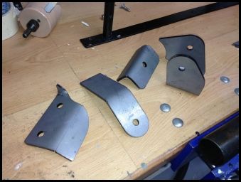

I got the majority of the steel I need to build this thing on Friday.
Laser cut parts........
Which I then bent to shape......
The quality of the cutting is incredible. The holes don't need drilling, the edges dont need de-burring or anything, its ready to use from the time you get it.
A couple of parts were a bit big for the flatbar bender I had access to, so for the big ones I went a bit caveman with them and beat to shape. I think I've mentioned my hammer in an earlier part of the thread.....its a big hammer. :lol:

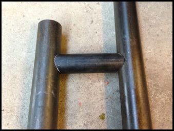

I also scalloped the smaller pipes to the right shape.
Again, the computer came to the rescue here making it easy. I printed some paper templates which I then wrapped around the pipe, spray painted to mark, then cut to shape. Pretty straight forward.

One great idea that a friend of mine uses is to make the steel plates self-jigging. He adds little tabs to some parts and little rectangular slots in their mates. That way they slot together and stay together when you weld them out. No need for expensive jigs and can be shipped to customer for welding without worrying that they won't put it together right.
The tabs and slots add a tiny amount to the laser cutting cost but a well worth it.

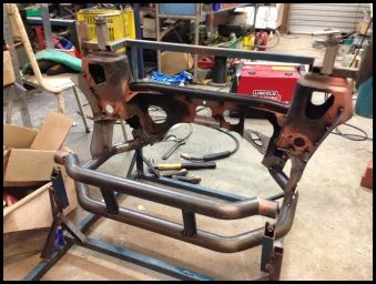

Small update: started frame assembly.
:D
I'm only tacking it together, I'll get it fully welded after I confirm the engine fits, that the frame fits the car, and that the engineer is satisfied.
