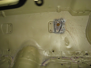

The body repairs have started as well. I'll be leaving the major rust repairs and panel welding to someone else when I drop it off this weekend but I've cut some pieces from my front cut to repair some of the smaller items in the good shell. I have also welded up the bumper holes in the front valance since I'll be going for the smoothie look all round.
I have drilled out all the spot welds in the old front valance and sills.

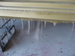

After sandblasting, there was hardly any rust in the sill exterior so I was initially thinking I'll just repair the rusty sections, but after shining a torch down the sills from the holes in the front wheel arches, I saw HEAPS of sandblasting media and some indication of surface rust inside. New sills are cheap as so it was worth the effort to remove them and I'll rust proof/paint what I can inside. I ended up sweeping up over 1kg on sandblasting media from each sill! It literally poured out of the spot weld holes when I bumped the shell!
I drop the shell off this Saturday to get the new boot, front valance, floorpans and sills welded in; and new steel welded in to replace various rust holes. The shell will also be desemed (both pillars & rear bumper).

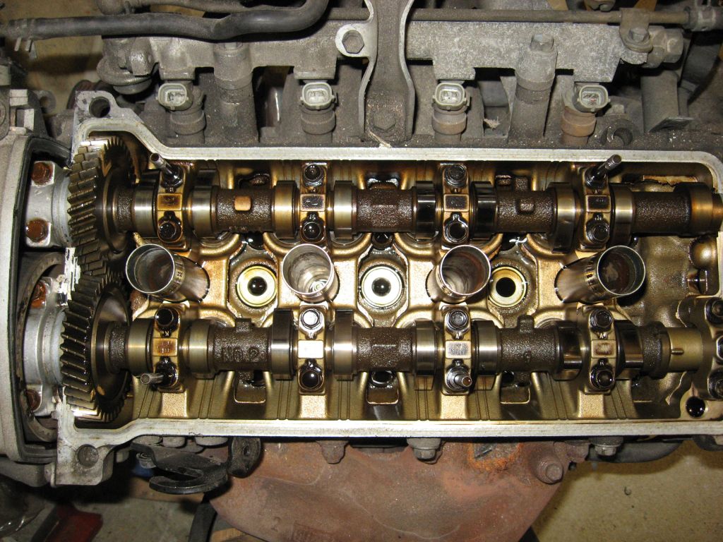

The company I imported the front cut through said that the engine was in excellent condition so I removed the valve cover to get an idea of whether there was any sludge or carbon build up to be dealt with. I was pleasantly surprised to see it was clean as. Second pic is a shot of another Starlet engine with similar kms to show what it could have looked like! It seems like my engine has certainly been well maintained.

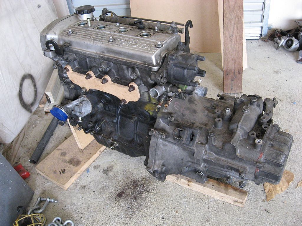

All sensors, open pipes etc have been VERY well taped up with electrical tape so they are sealed and protected when everything gets blasted. To seal the intake/exhaust & water pump ports, I made up some blanking plates with 9mm MDF sheet (as seen in the pics below) and will be sealed with gasket maker. My mate who will be doing the blasting has give me a tip to insert foam earplugs in any bolt threads so that the threads are not damaged during the blasting. Once a light blasting is complete, I will mask everything up and paint it in high temperature engine enamel.
Engine stripped (fuel rail & injectors still attached at rear) with gearbox still on :

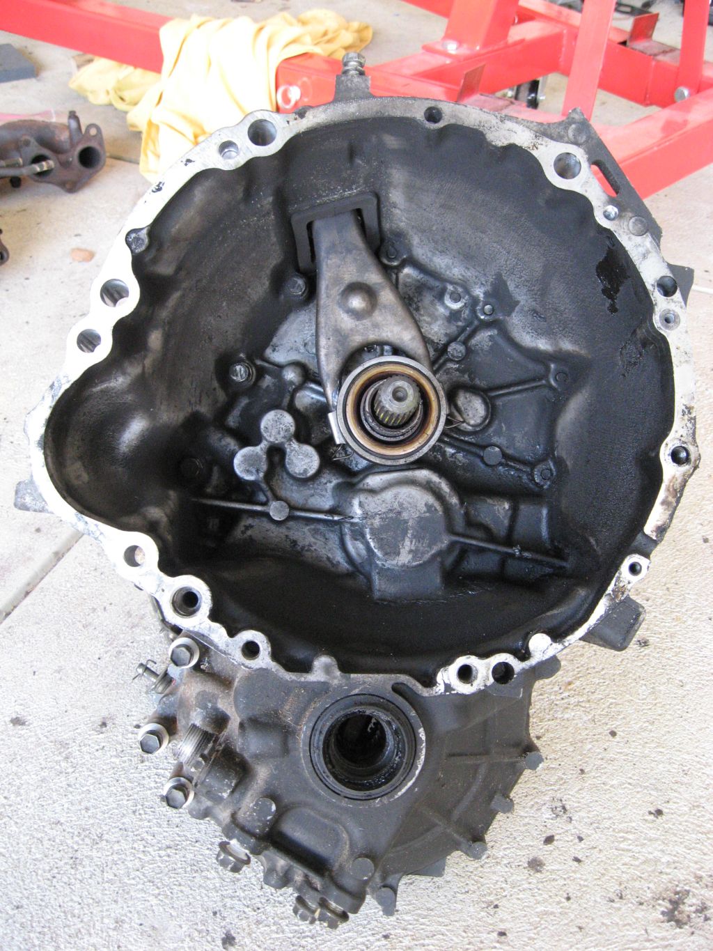

Gearbox removed & clutch removed. I made up a simple wood stand for the engine to sit on too and some rag have been stuffed into the holes where then injectors normally are. One question that I'd need answered : How do I remove the flywheel bolts since the crank turns when I try and loosen the bolts. Is there a trick to holding the flywheel in place to undo the bolts? I was thinking of getting some steel tube/plate and bolting it to flywheel and creating a kind of chock (against the ground)?
Heaps of build up of crud in the bell housing (easily cleaned up)

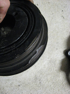

I managed to drop the crankshaft pulley and break a piece off. Bugger :cry:
Should I look at replacing the crankshaft pulley because of this??
-Alan
PostPosted: Thu May 20, 2010 12:52 am
Posts: 2002
I dropped mine as well, they do chip quite easily. Not as big as yours though.
If youve got a mate spare with a lathe you could get him to see if its still true.
